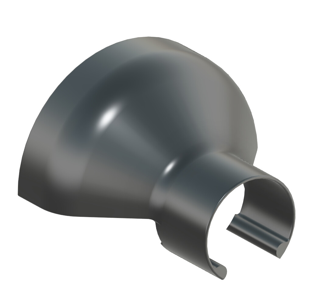

I am starting to use Fusion 360 and probably will be forced to go full bore in the near future. I don’t think that there is any comparison between the two, of what both software programs can do.
For the simple stuff, it works great but and is easy to use. Below is the first ā€œfrom scratchā€ part that I did..
