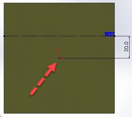

In my case, (SW2022 sp5), no matter the axis is visible or not, the point is created on the origin of the sketch, and doesn’t move with mouse, as the video shows. I simply have to grab it, move it a little and then coincident it to the origin or somewhere else.

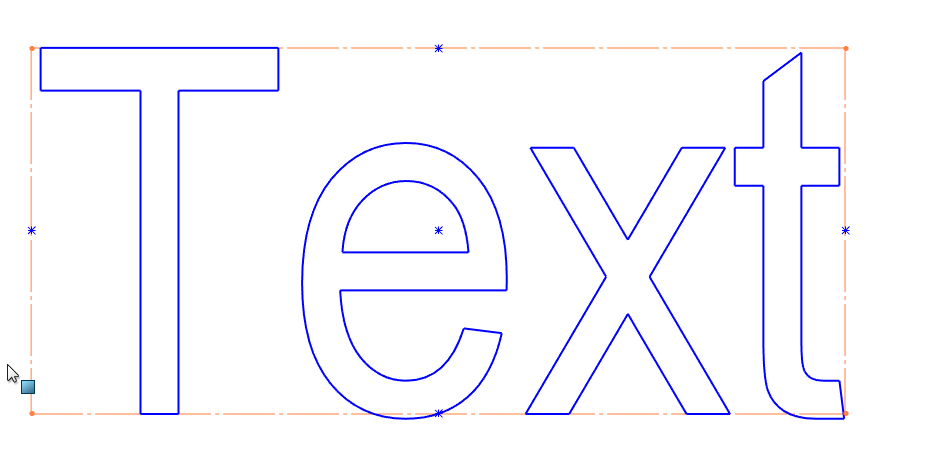

There should be several points, the one for each quadrant and the center.
Nothing in the help references that point.
Sketch Text
I only see the one point, that defaults to the origin.
If I’m not mistaken, there was a construction line that came with the text originally that would be used to orientate the text. I think it was removed when they introduced the ability to make it follow a curve. and the point replaced it.
I meant that’s how they should change it…add boundary points/geometry that can be used to control the location.
This isn’t great advice. If you constrain the point to the origin, and then later delete the curve that the text is attached to, you will have a Sketch error (this is normal, anytime you delete the line). However, if you edit the sketch text to eliminate the rebuild error and don’t choose a new line, the text will jump to the location of the point, which may be far away from the desired location. Better to keep the point near your text so it doesn’t go flying off unexpectedly. Since you are attaching the text to a curve, it’s safer to attach the point to the curve and add a dimension if necessary to fully pin it down.

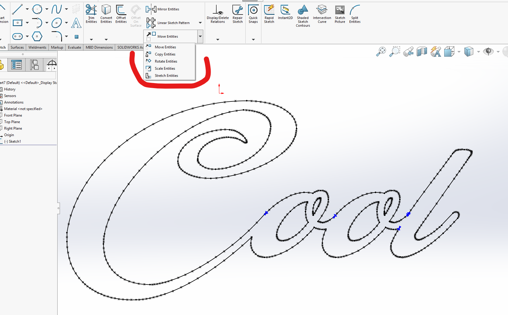

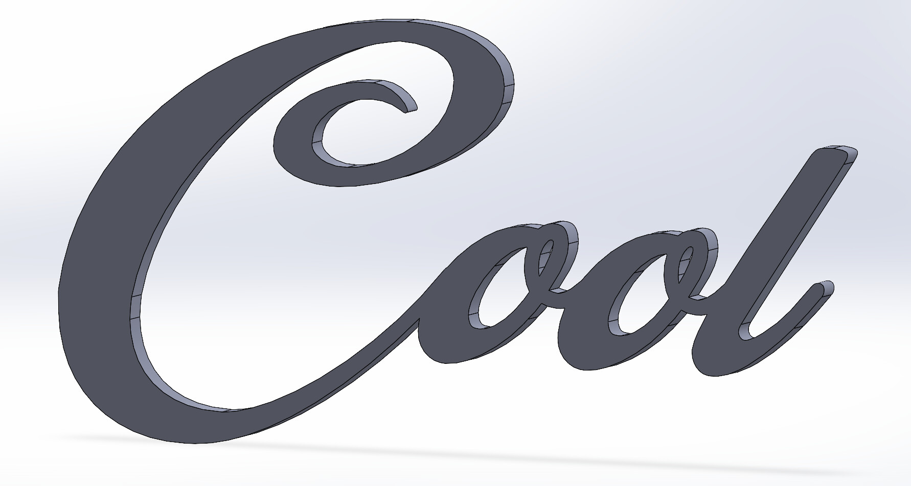

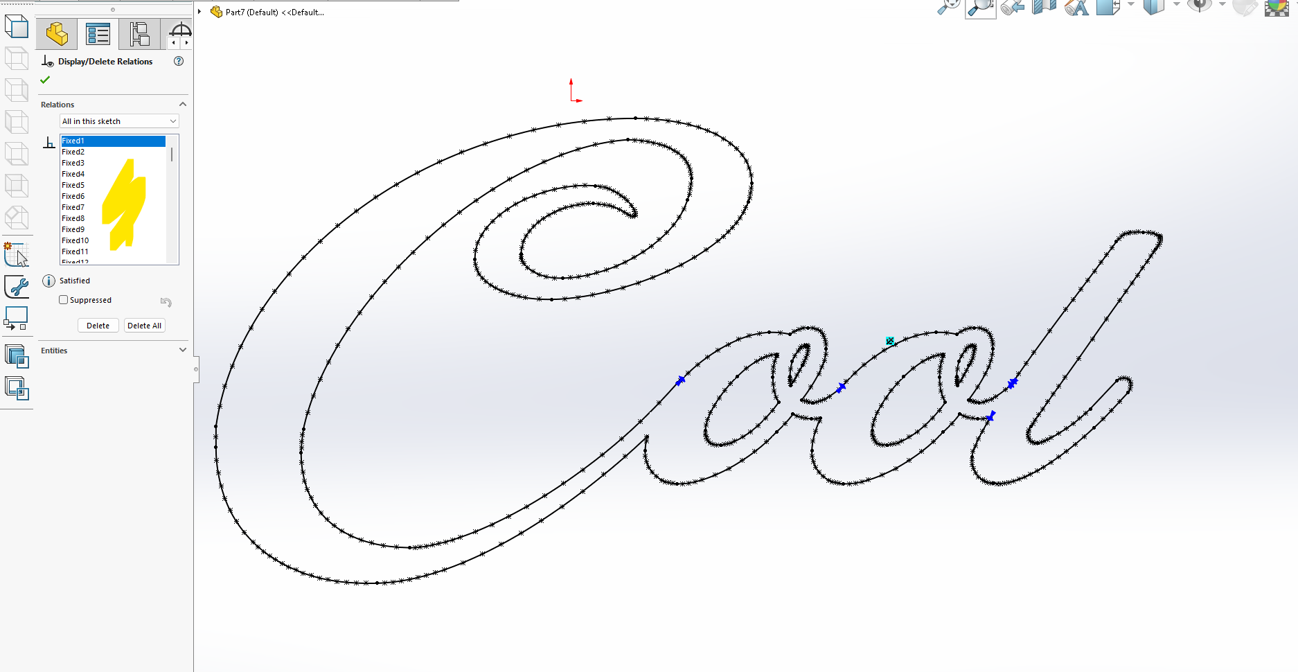

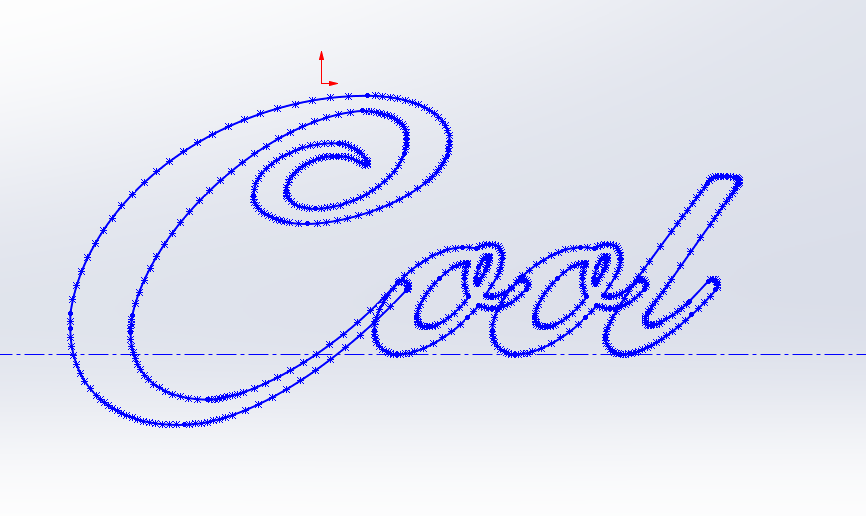

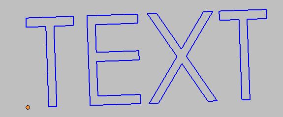

FYI you can also dissolve sketch text to geometry.
you can then trim it up and make it fixed
you can move it around, rotate and scale it 2 different ways
see 7 pics I did, I make alot of stuff to 3D printing, laser cutting and CNC engraving,.
being a model maker\prototyper someone always needs texted and have it tweaked, so between SW, CorelDraw, InkScape, Illustrator and LightBurn I can make some Cool stuff.
