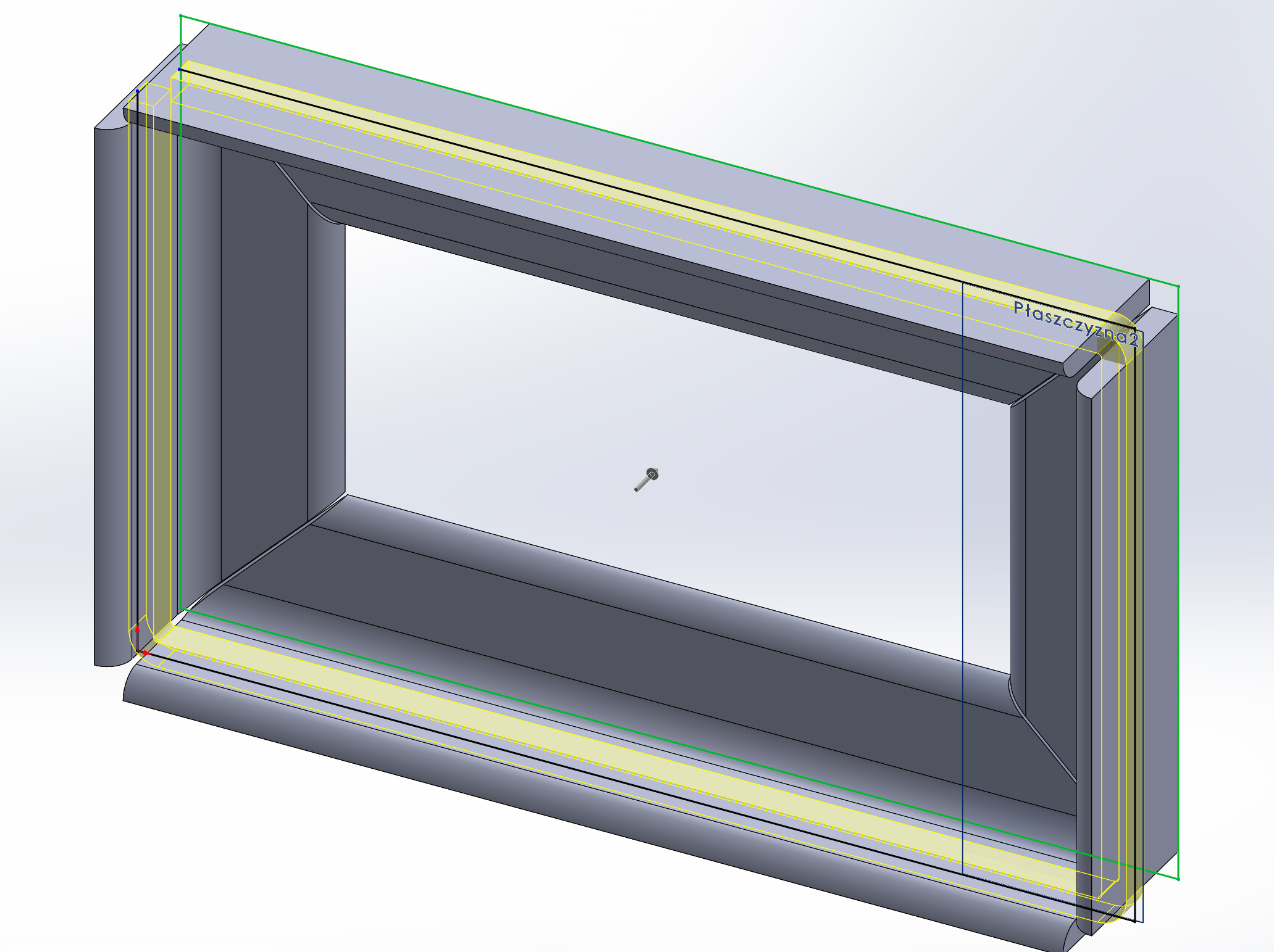

So I was having some fun this morning… :smiley:
This is a great example of the Sheet Metal / Combine method. As a side note, I learned that Solidworks doesn’t like to fold in two different directions at once, hence the two Fold features at the end of the tree. I was pleasantly surprised that it creates only one flat pattern and seems to work flawlessly in that regard. ><

I was able to get your test file to unfold by using “Convert to Sheet Metal”, instead of “Base Flange/Tab”.
  1. Extrude your radius instead of Base Flange.
  2. Combine all bodies
  3. Convert to Sheet Metal, and select “Keep Body”
  4. Combine, selecting sheet metal body first
  5. Add fillets to replicate your angle profile.

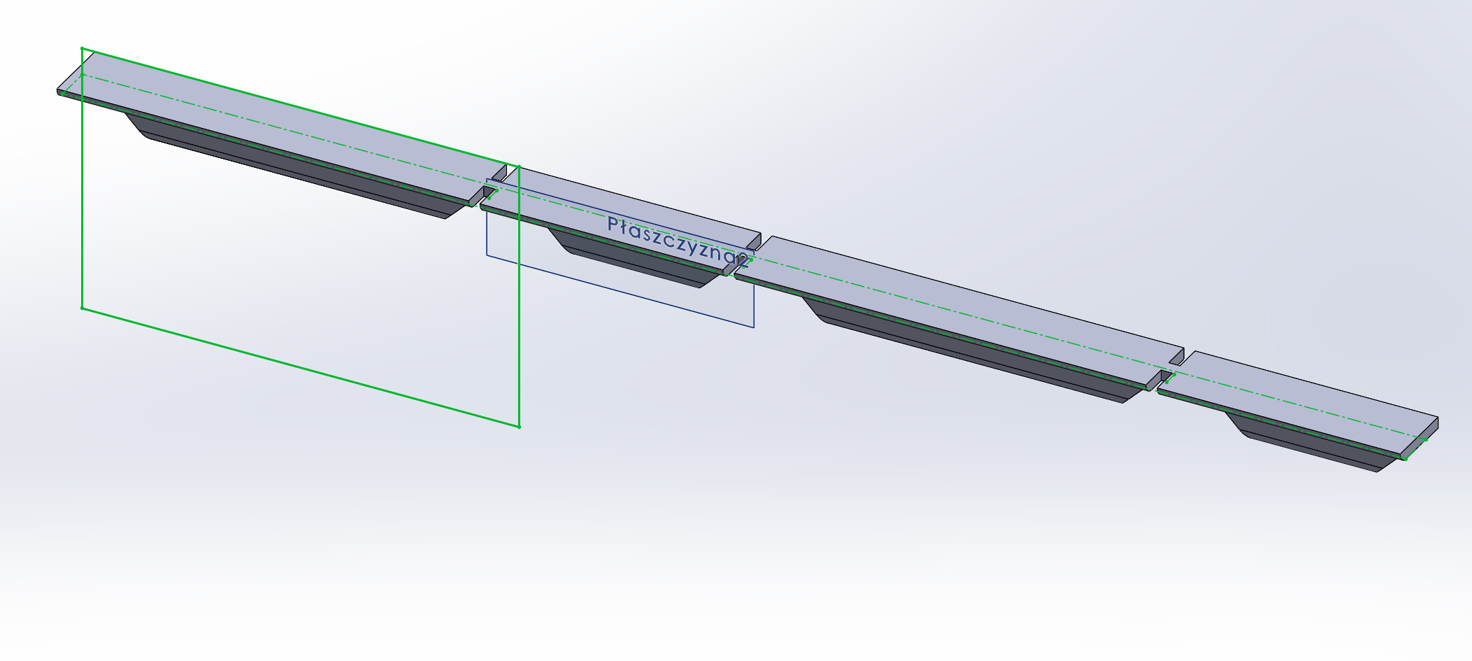

Understood. I played around with the test a little more and I was able to get it to flatten if I created a Base-Flange that overlaps the whole weldment.
Obviously this will depend on the geometry that you have in your model, but it might be an option.
Thank you Tim, that is even quicker method.

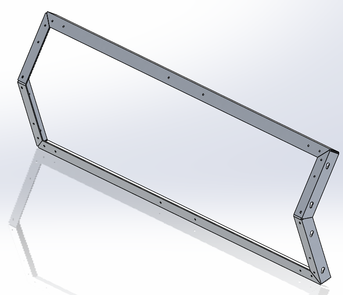

Right now I am facing my biggest challenge - I have one frame that will be bent in two planes. IF I could get @mike_miller’s method to work, it would be simple. Unfortunately - as with previous files - I cannot unbend more than once. Using @Tim Hoover’s method I would have to “bend” every corner of angle profile, and then remove them from flatten operation and replace them with straight corners, am I right?

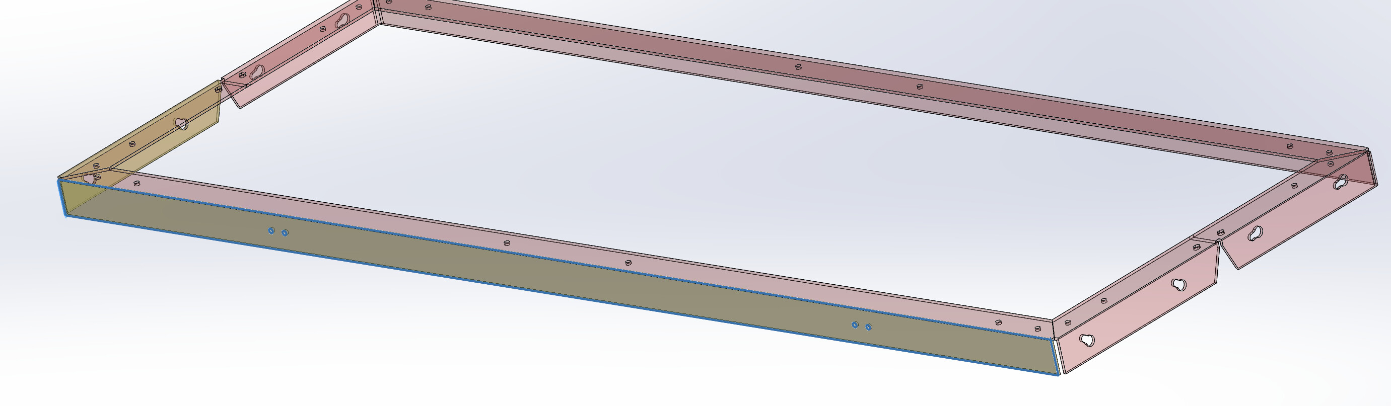

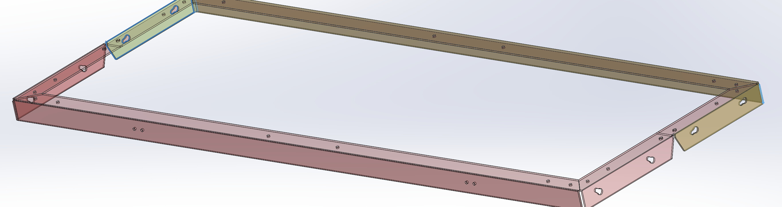

Not sure if it is any faster, but I did find another option.
  1. Flatten the 2 bends to make the frame flat.
  2. Make a boss extrude the size of the whole frame.
  3. Combine “Common”.
  4. Convert to Sheet Metal & Keep Body (x2)
  5. Combine
