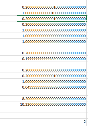

Nope, apparently it’s rather random since it’s a FP error. Change that to a number and extend it out to 30 decimal places. Below are a bunch of simple subtraction, division etc problems that I did yesterday.
For some reason addition seems to work flawlessly.
There’s defiantly FP issues in SW but I’ve not seen so many cases that are so egregious. For instance I created a Driveworks model that did these same calcs and it always came back with the correct numbers.
