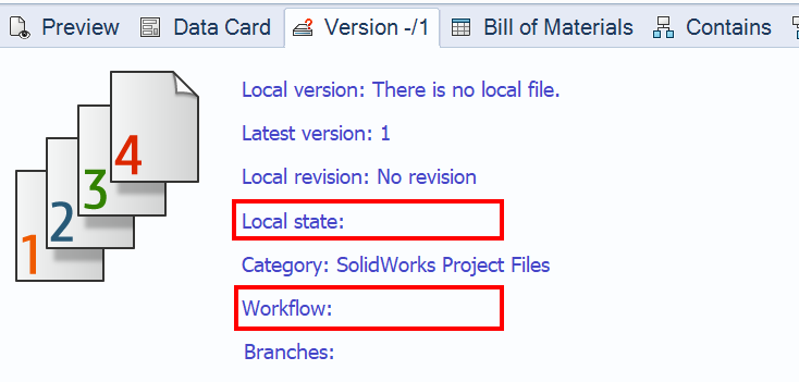

Hello! Our SW PDM vault has several thousand files without any State or Workflow. It appears to have happened somehow after a delete then recover operation. I’m unable to transition them to any new state. Any ideas on how I could fix this? I’ve been eyeing up the CurrentStatusID column of the Documents table, but am leery of messing with the DB. Thanks!

I think the files were but added to the vault, so they existed in the archive. I deleted them as Admin then recovered them around 30 min later, which left them checked in without a state. I tried reproducing it yesterday (in 2022 SP5) but they went into workflows correctly. At the time these files were deleted we were on 2020 SP5 and the category and workflow entry conditions had issues, so it may have been related to the old version or the bad conditions.
I was able to “fix” the issue in our test vault yesterday via the database but am running it by DS before doing anything in our prod vault. Yeah, the trouble with database mods is that it might appear to have worked, but then you find it’s broken in some other area of the software. You don’t know what you don’t know. Cheers.
I checked with DS about my “fix”, just got a generic reply about the perils of DB edits. I ended up just copying the problem files with a suffix, checking those in, then deleting the originals. I realised they haven’t been visible to anyone but Admin anyway, since no users have permissions to view a state that doesn’t exist. Thanks for the input.
