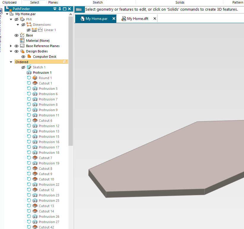

I deleted a sketch and about 5 design bodies vanished. All the tree features list as hidden. How do I fix this?
Edit:_ I should mention that the sketch was the last item in the tree.
I have used the Windows “File History” to get around the problem.
The swish symbol shown signifies that the features are rolled back either because Protrusion 1 is actively being edited or you manually used the GoTo command to roll it back to there. Either finish the edit or use GoTo on the last feature to roll to the end.
I chased my tail for a while trying to figure out what i did when that happened… i was playing with roll back after reading about it here one day.
