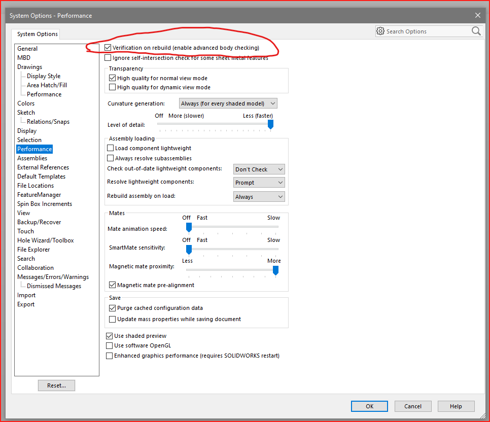

Is this setting turned on?
If not, my advice is to turn it on and leave it on.

Doesn’t matter if it is turned on later or not. If you put a new version of Solidworks on your computer, as default, when it rebuilds it does the in-depth rebuild = the same as verification on.
This is why you would see designs that worked perfectly fine in in a old version suddenly go back years later it doesn’t rebuild. The problem is likely that it was always there it’s just the new version by default does in-depth rebuilds on old files until it is saved to new version with the rebuild.
I don’t know how much of an impact it has in 2022, but turning that on will slow things down.
As Dan says tick verification on rebuild and in addition to that do regular Ctrl+Q on complex parts.
