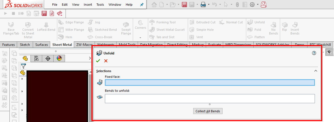

I am using feature manager that is “docked” beside the feature tree.
However, when i start using SW2020 recently, the feature manager “width” then to get very wide, even if i resize them, when I restart the Solidworks it get reverted back to the wide size. grumph

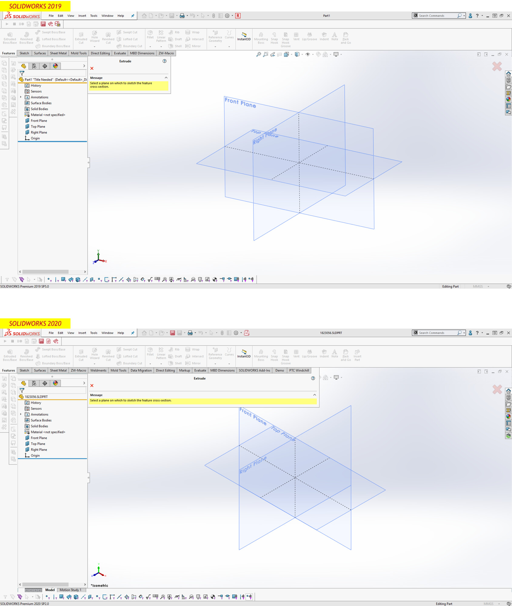

Well… this is the weird part…
It IS properly size in our template created in SW2016
When creating part in SW2019 using our template, the PropMgr window appear OK
When creating part in SW2020 using the same template, the PropMgr window got messed up
