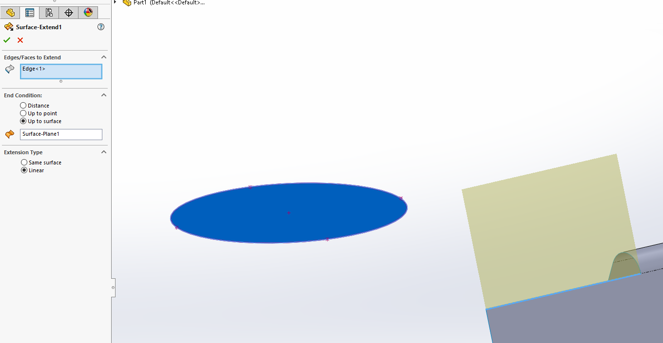

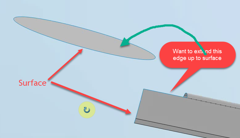

All are surface in this video shows. I want to extend the flat surface up to the circular surface but extend up to surface does not work. How to fix it?

I’m not sure from your picture, but I may know what’s going on.
What you are extending up to the surface has to fall within the bounds of the surface. If you are trying to extrude up to a flat surface, you can use a plane instead because planes are infinite. But, SW correctly chooses not to extrapolate outside of the surface you are extruding up to.

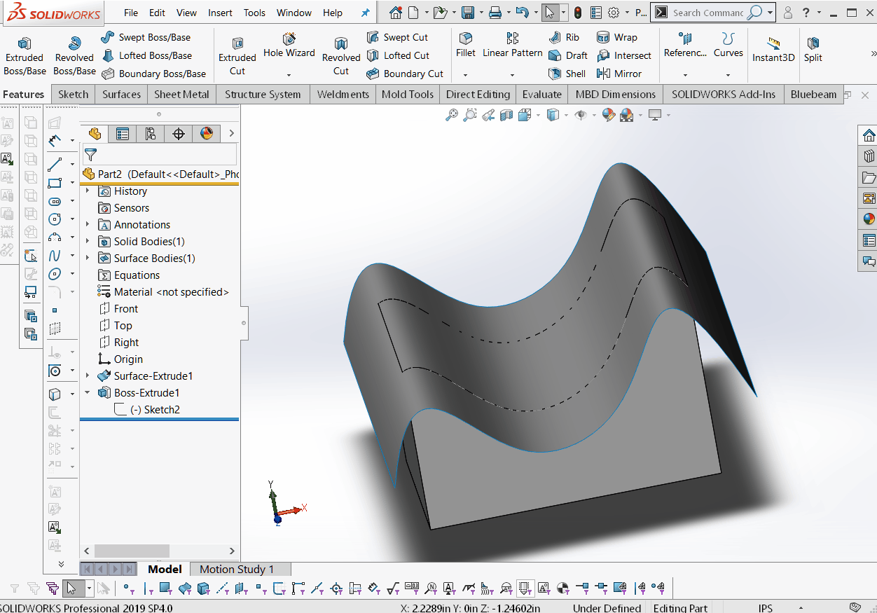

mattpeneguy Unless 2021 enhanced this feature, it works when its not intersecting.
Wow, you are right. If the surface is planar it works.
