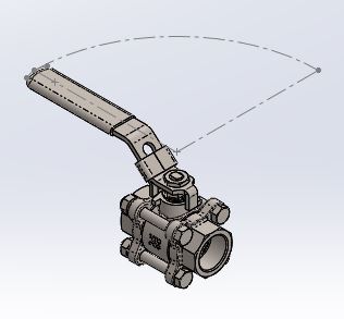

Ball valve handles, as well as any other moving component, have a range of motion and corresponding potential clearance requirements as it moves. I have represented these simply with a planar arc sketch for a typical handle swing. I am able to view it from dynamic angles to judge its clearance around other components. It works ok for its purpose. I’m considering an improvement of using solid bodies to check for interference.

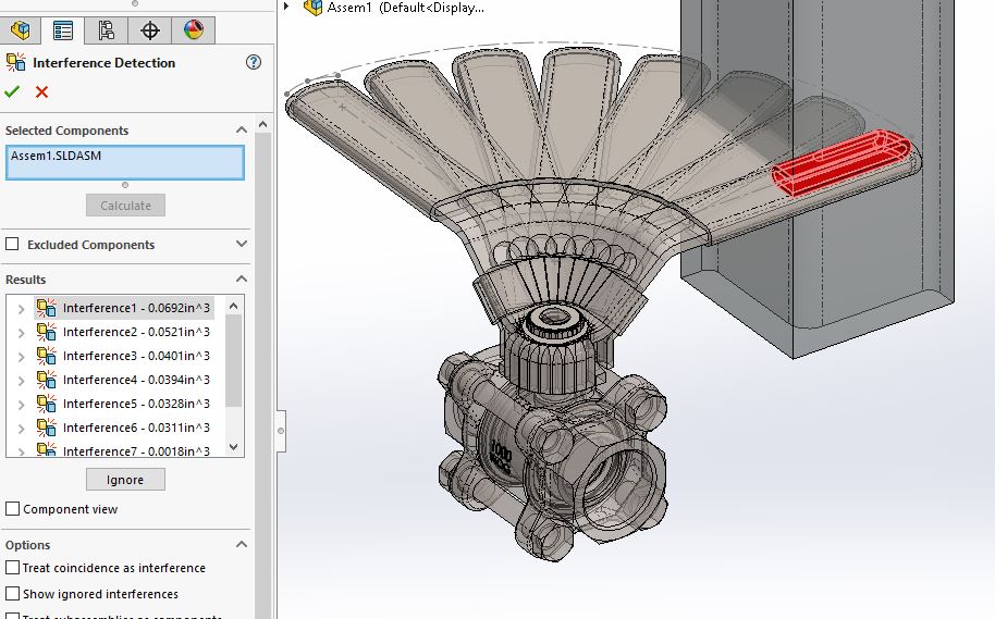

I had some time to try it out, to pattern the bodies within the part. Here is my original valve part:
I add a Pattern, make it Air material and delete some appearances that came with the new pattern bodies.
Place in an assembly, create a simple weldment angle to obstruct the handle. Run Interference Detection. Get results.
Then, I went back and hid those bodies. Interference Detection still found the same list of errors.

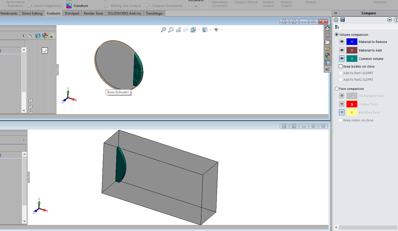

In the past, I have created a path for the handle, and then swept a good approximation of the clearance that I want around the handle along that path. Then, if the interference between the clearance and whatever it is I want to check is really hard to see, I will make sure that the two parts share a coordinate system, and then do a compare documents (this allows you to see the areas where the two documents share a common volume without changing either component)
