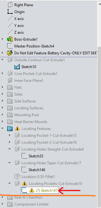

Hi all,
well it happened again the red line indicates the sketch (147) I am in and the orange was where I had the part rolled back to before I went to drag a center point with detach with drag on and the sketch 10 was shown so I will play how this happens?
Regards,
Jim
