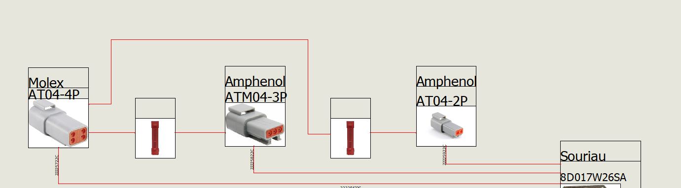

I am currently designing harnesses for aero industry. I have a schematic drawing and I have to make a 3D harness out of it. So first I made a line diagram where I used all elements (connectors, splices) successfully. But when I want to add cable shield terminators into the line diagram the problem comes. I cant find a way to make symbol with passing circuit. A cable that goes through terminator (CWT) should remain unchanged, only the one wire - that connects to the shield of the cable, should be added. In some cases this wire goes to the connector pin, in some to the splice. But I cant find any proper solution to make symbol with hyper passing circuit or something similar, so the main cable can remain unchanged. Cable core reservation also dont work.
I also tried to make automatic harness out of schematics, but CWTs dont connect properly - they dont connect at all.

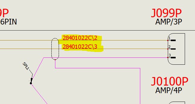

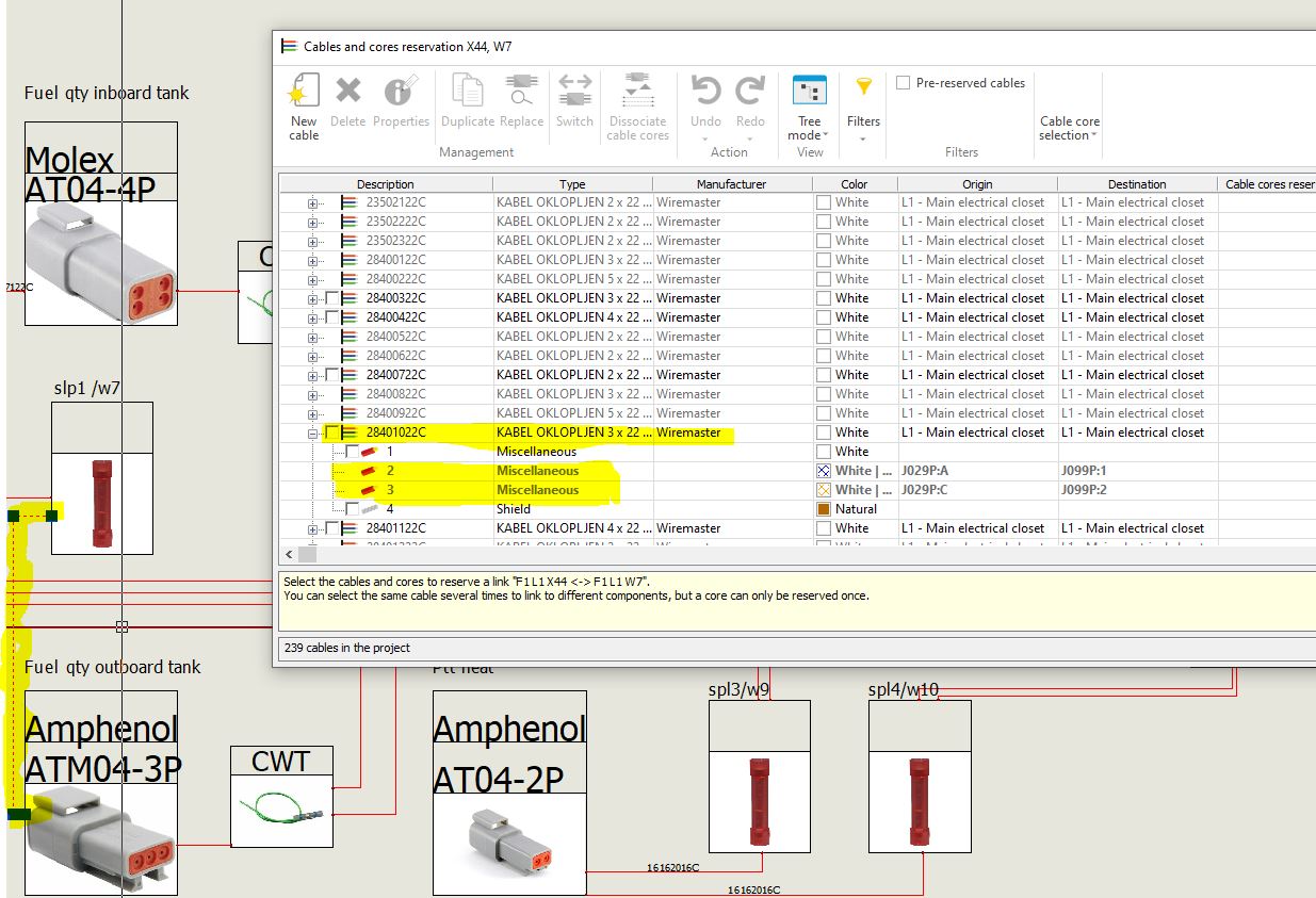

Other question is, how can you associate the same cable in schematics to the same cable in single-line diagram? First two pictures have yellow highlighted the same cable in schematics and in single-line.
Other are pictures of the most simple part of harness for easier understanding. (in single line cwts are not yet added). In the last photo is cable shield terminator (CWT).
