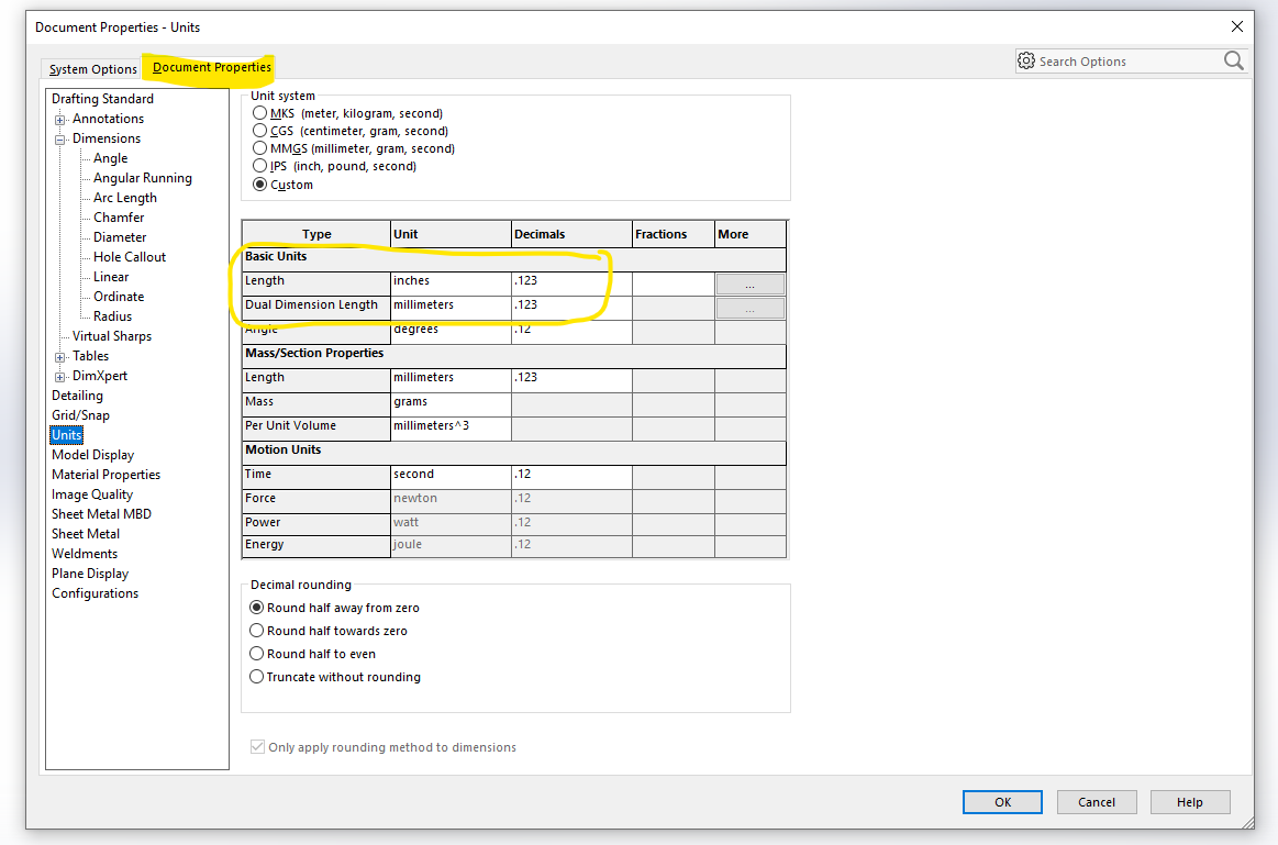

Hi Ben,
In Document Properties under units I think you can set the dual dimension as below.
Hope this helps you.
Good grief, it was right in front of me, couldn’t read. Thank you for kindly pointing out the obvious. I should have went home at 4:30 yesterday…
Hey Ben,
If you end up “customizing” the units manually on the dimension, then they return to the same unit when they are rounded up. Just a heads up!
