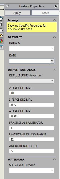

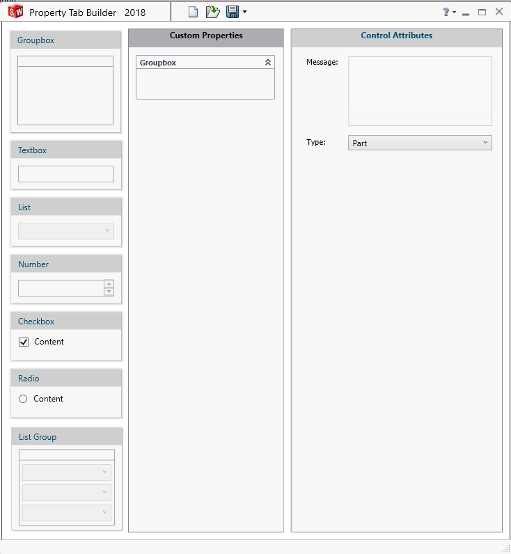

However, have you looked into the Property Tab builder?
Basically, it is an area that you can use to populate custom properties of any file using drop down menus and whatnot. See below. That last picture is an example of what we use here. (I wish that there was more intelligence in it, but there isn’t)
Love the Property Tab Builder. I use the property tab area to populate my title block(s), and it is a great help. I was just wondering if there was any way to make my process even more awesome.

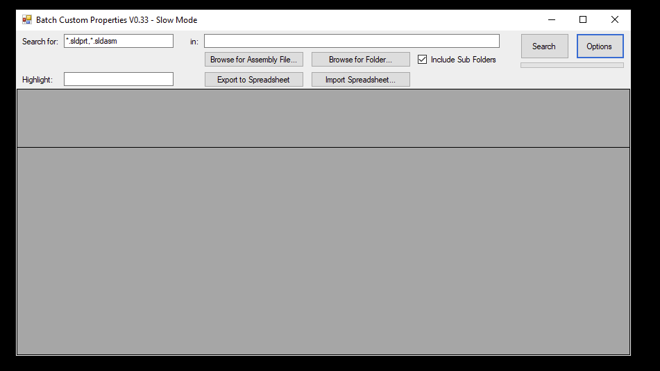

To update the custom properties for a set of drawings or models or assemblies
I use a very handy “Batch Custom Properties” utility by Fifi Riri
a screen shot of part of the help file:
I can post a link to get it if anyone desires to try it.

I did actually find a ZIP for “BatchCustomProp.exe” in the comments to the Solidworks Forum posting. Am i allowed to post the ZIP file?
