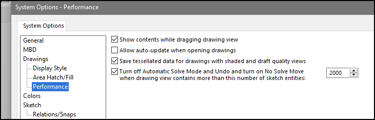

What do you have checked for this area?

When you save a drawing, are models saving as well? If models are saving, it is possible that you have models that are set to rebuild all configurations on save, or update all display data on save, and that is where the slowdown is occurring.
