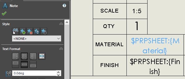

Drawing Template Wordwrap text position not updating.
I have a template with wordwrap and “snap to rectangle centre” to keep it from overlapping into adjacent boxes, but when I insert the part the text doesnt update position to the centre if it has 1 line. If the part has enough text for 2 lines it works fine but on only 1 it stays at the top of the box.
The only way I have found to fix it is the edit sheet and edit the text, where it will fix itself automatically. Refresshing or Ctrl+Q does not fix it either.
Is there a way to automaticaly centre the text? am I missing something
This is 1 line of text and the only way i have found to fix it manually:
But when the part has 2 lines of text its fine:

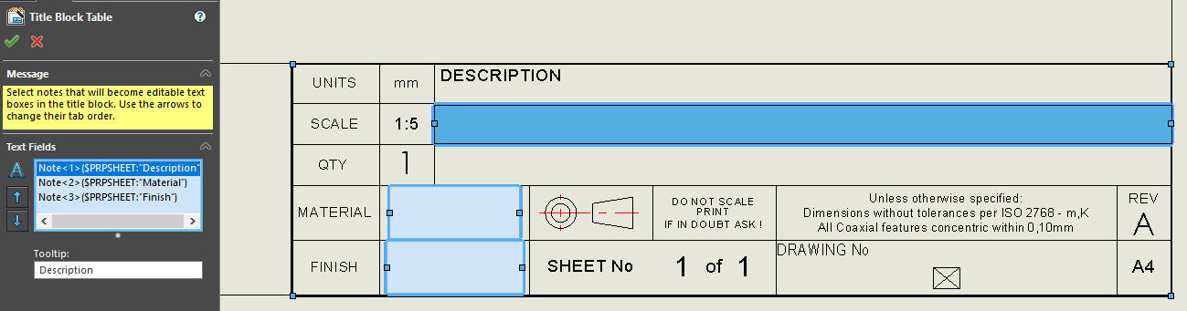

How is the title block created? Is it created as block?
Do you mind sharing the files?
The Text fields are notes and this is the title block
For the file do you only need the slddrt file or the drwdot file aswell
I tested this and confirm this is a bug on SW 2020 SP4. This is one of those things that would be easy for them to fix, but it’s probably been around for years.
You could see if your VAR can open a ticket on this.
