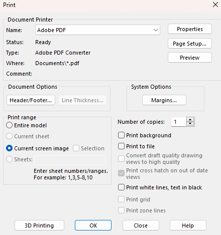

You might get better results using print to PDF.

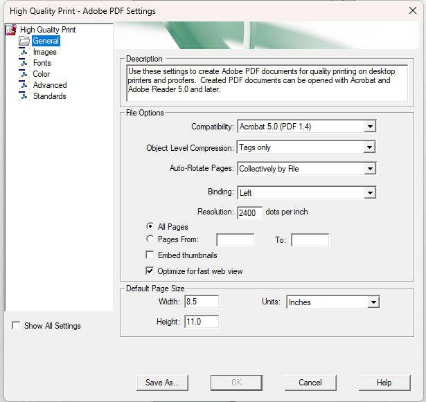

Clicking the “Edit” button on the “Default Settings” line brings up these options. I’m not sure if any of those will accomplish what you are looking for. (I’m not familiar with OLE.)
Is that the PDF printer that is installed with Acrobat? It doesn’t look familiar.
That is possible. I have adobe installed.
I always use the adobe PDF through the printer, it just gives you a lot more options then the save as PDF does. And I am dating myself, but when I started using solidworks save as PDF was not an option.
