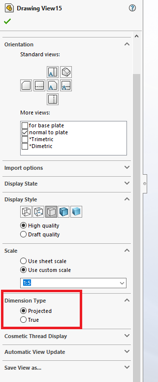

If your dimensions on the drawing don’t match the model there’s a good chance you need to change a setting under Dimension Type in the drawing view’s property manager (see the screenshot below). If the drawing view is isometric you probably need to have “True” selected. If it’s a flat view (such as the one I just had that was referencing a custom view, “normal to plate”, that isn’t parallel to either of the standard views), it probably defaulted to “True” and you need to select “Projected” instead.
If you’ve already applied dimensions (like I had) they’ll be deleted. You will need to add them back in. No, there’s not a way around it.
To reiterate, this is in the drawing view’s property manager, not in the Smart Dimension’s property manager.
