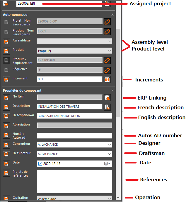

For instance, this is the property interface we built
We can create projects and assign them.
We can link the part to something in the ERP if needed.
We have a “dictionnary” built for our descriptions, to ensure having the same names across.
We have a section for an AutoCAD number, which is pretty much to grab an existing item in the ERP and rename it to the new part number in SolidWorks.
We have a section for operations such as plama, bending, cutting, etc..
Every list that has an arrow is a drop-down that I can manage to add/remove options.
The date thingy is an actual calendar
You can set options to have whatever removed upon creating new parts. For instance you could remove every operation to make sure that people reassign operations every time a part is created.
It’s pretty frickin sweet!
