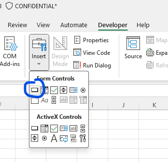

It wasn’t done programmatically. I just dropped in a shape, then a button using this command
Selected both, right-click, and group. Are you able to un-group the ones in this file? If so, can you re-group?
Looks like grouping a shape with any of the objects on that “Form Controls” menu causes this crash. Even a “Label” control, which is pretty much just text.

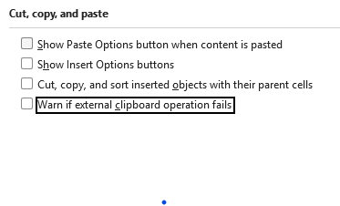

Go to File \ Options. Select the “Advanced” tab. Go to the “Cut, copy, and paste” section. Uncheck “Show Paste Options button when content is pasted” and “Show Insert Options buttons”
I went ahead and un-checked all of those. No change.
It seems to be related to Excel’s interaction with the clipboard itself. While Excel is in the process of crashing, I can’t copy/paste other stuff.
