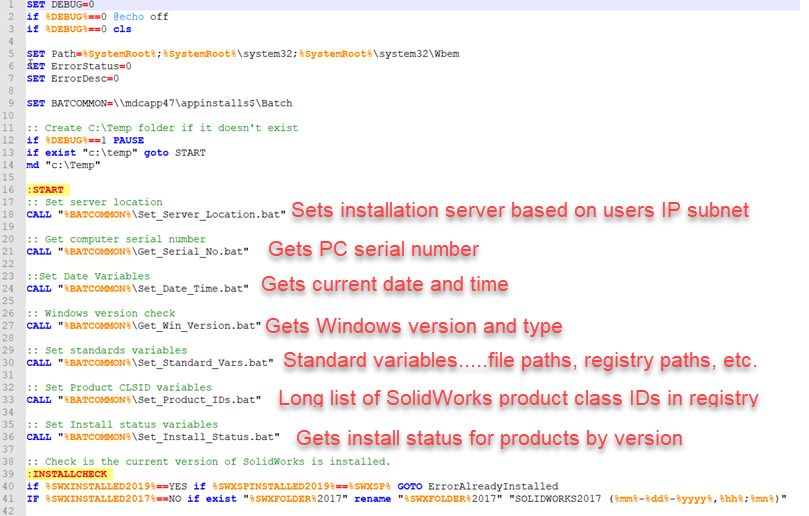

I have a ton of batch scripts that run first. These are not kicked off by the admin image but instead calls for the admin image when its ready. They are used for more than just SolidWorks and collects and logs data for troubleshooting.

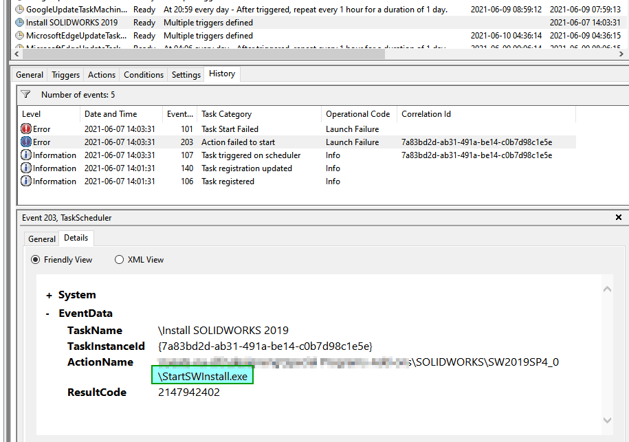

In solution 07028 I’d say they missed a step of connecting to remote computer. Thank you though for pointing out it uses Task Scheduler to do the installs, bit of a duh moment for me there. So I was able to look at the task on the remote machine and found that there is a problem. Would be nice if the status in the Admin Image Editor would indicate that there was an error. Anyway here’s a screen shot:
So I look up 2147942402 (thank goodness MS got universal ResultCodes right so we can search them) sounds like missing file.

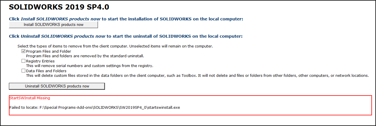

Yep, there is no StartSWInstall.exe, just the .hta file.
Any guesses why there’s no .exe file created? Wondering what I messed up…
That sounded familiar then I remembered that trying to uninstall SW from a client machine using the hta never works; complains about missing .exe.
