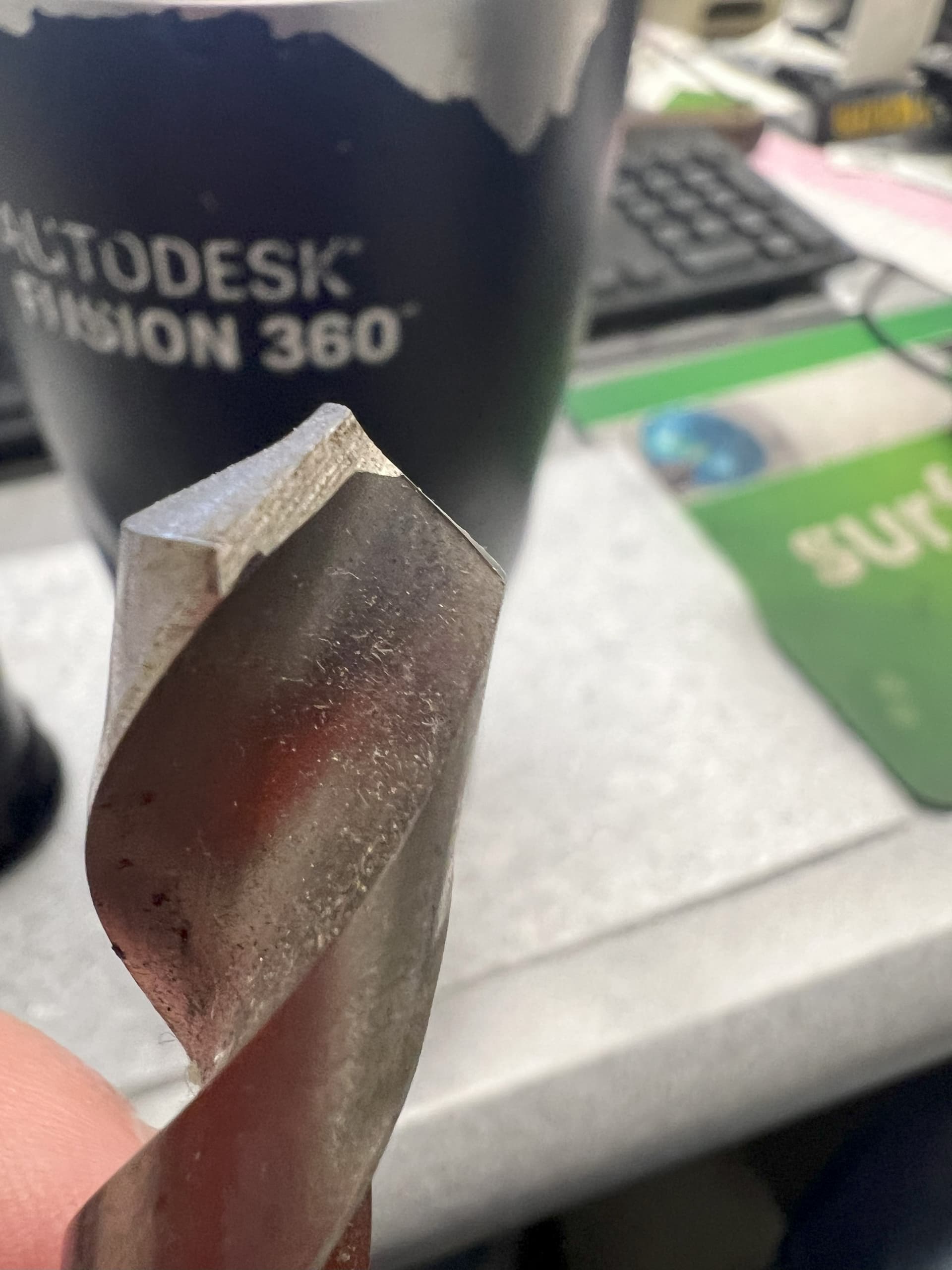

you can also grind a slight flat on the drill, taking off the curl at the tip the causes the grab, with this the drill scraps the the hole and you usually dont need a backer.

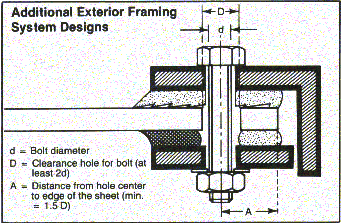

If you are using TAP Acrylic Drill Bits, leave them sharp as is. TAP does recommend oversize holes and the use of gaskets to allow for thermal expansion, but do note that thermal expansion issues only occur when you mount acrylic sheets in a frame made of a different material. If your construction is all acrylic, you can make tight holes without gasketing.

cheaper to just grind the flat on the front edge of regular twist drill works the same as the ones ground for plastic, also better for blind holes becuse they have a flater tip.
as a model maker I have cut tons of acrylic parts and the home made drills have never failed me in 40 years.
