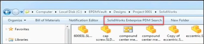

Wonder if its related to the long standing bug with launching the login from the standalone search tool. If the user clicks on a shortcut to the “search.exe” in the PDM folder, the login prompt comes up but it doesn’t cache the files. You have to logout and back in. This is really old…like a decade.
I tried getting around but forcing the auto login but we have recently went to a new Windows image using Microsoft Azure AD cloud logins and PDM doesn’t support it. Our PDM is still hooked into our old local AD. Thinking of breaking it from AD and just go straight PDM logins.
I wonder if that is why they hide the Search.exe with no out of box shortcuts in start menu or task bar? The out of box way to access the Search.exe is through a vault view.
I did not know about that the cache on login does not work when login starts in Search.exe We have automatic login set (since we’re connected to AD) so PDM is logged in through Outlook most of the time I think.
I’m on 2022 and I struggled with the autologin and file caching. I eliminated the problem by only working on 1 computer, but will eventually be a problem when there is a second designer.
I don’t think there has ever been an official shortcut to the search.exe, you launched it from from inside the vault. We manually created it and then added it to our deployment package.
It must use some different code to login that misses the auto-cache that was added later. I had an SPR for it at one time but can’t find it now in their knowledge base.
