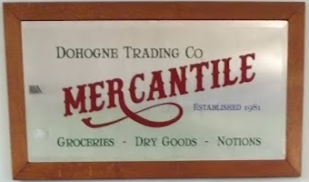

I recently finished this project. It is an antique 20" x 45" mirror that I burned the silvering off the back and then painted. I had to reposition the laser about eight times to burn it all and there are some alignment techniques with that that Lightburn handles very nicely.
There are a lot of tricks and techniques involved with these lasers. One handy trick I learned is to wipe light colored bare wood with a solution of Borax and water and let it dry before burning. There are many other techniques from a very helpful user community.

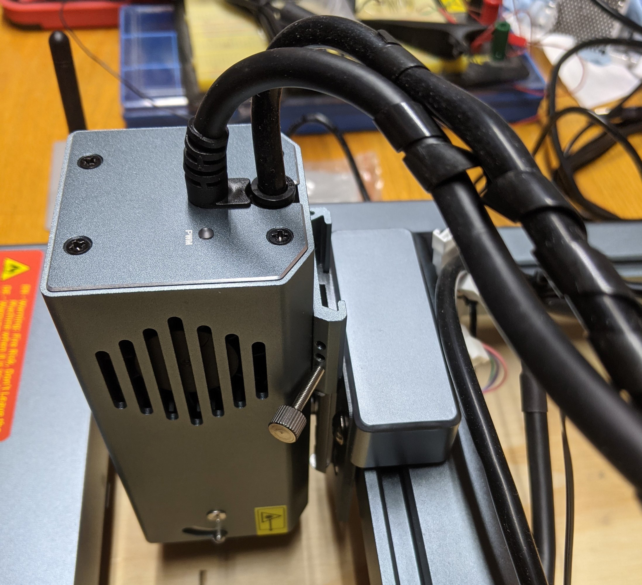

I got the additional vertical adjustment which didn’t come with instruction. So didn’t put it in. It’ll allow more vertical travel.
Stock setup is about an inch travel. Just slide and screw to lock.
The frame was designed for smaller laser. The fixed stop on the frame will cause the 20W to hit the frame.
The vertical addon will reduce Y travel. Nothing a 3D printer can’t fix.

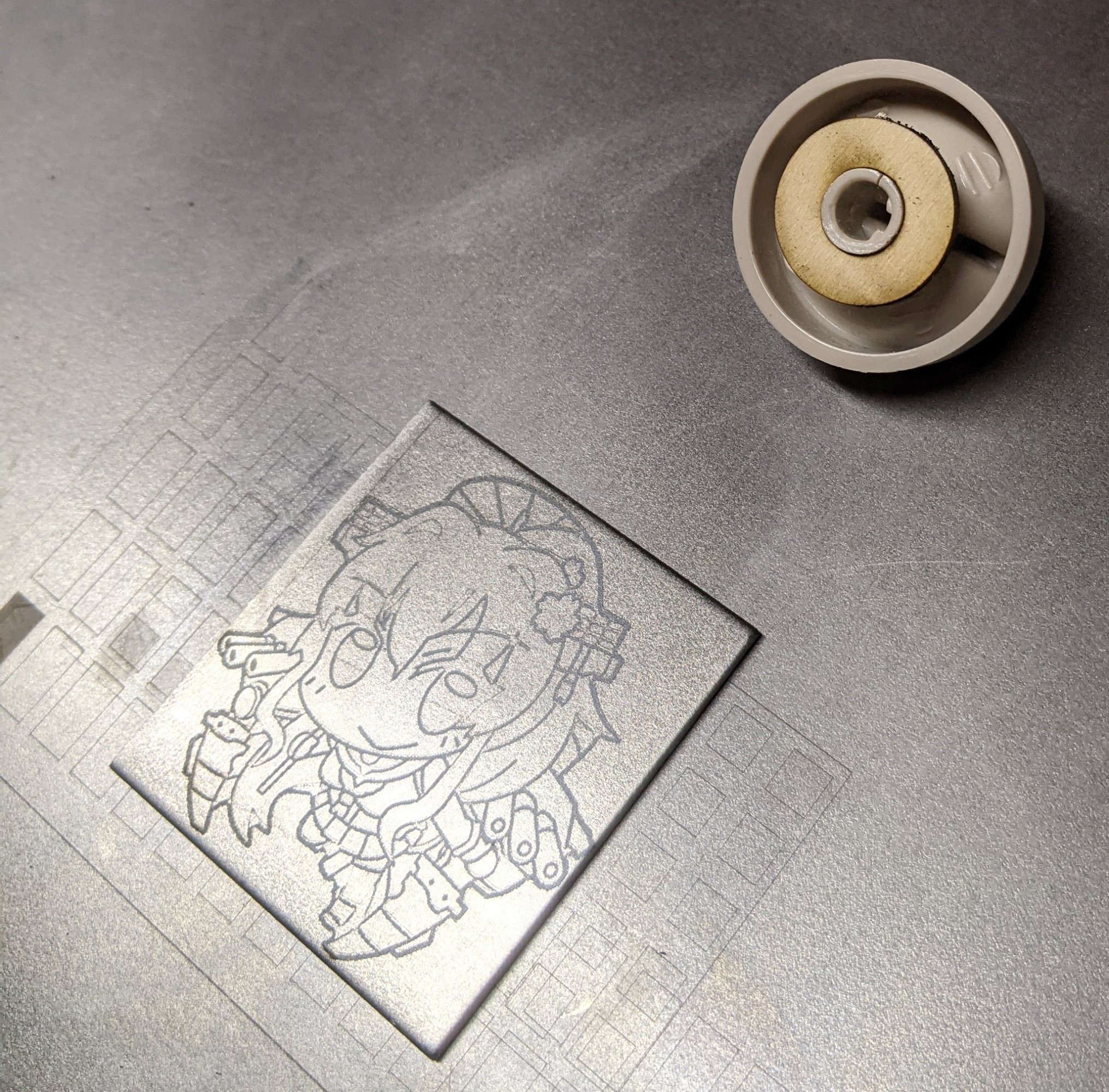

Fix a broken knob and engrave on steel.
1.75" SQ 1.5 hr to engrave.

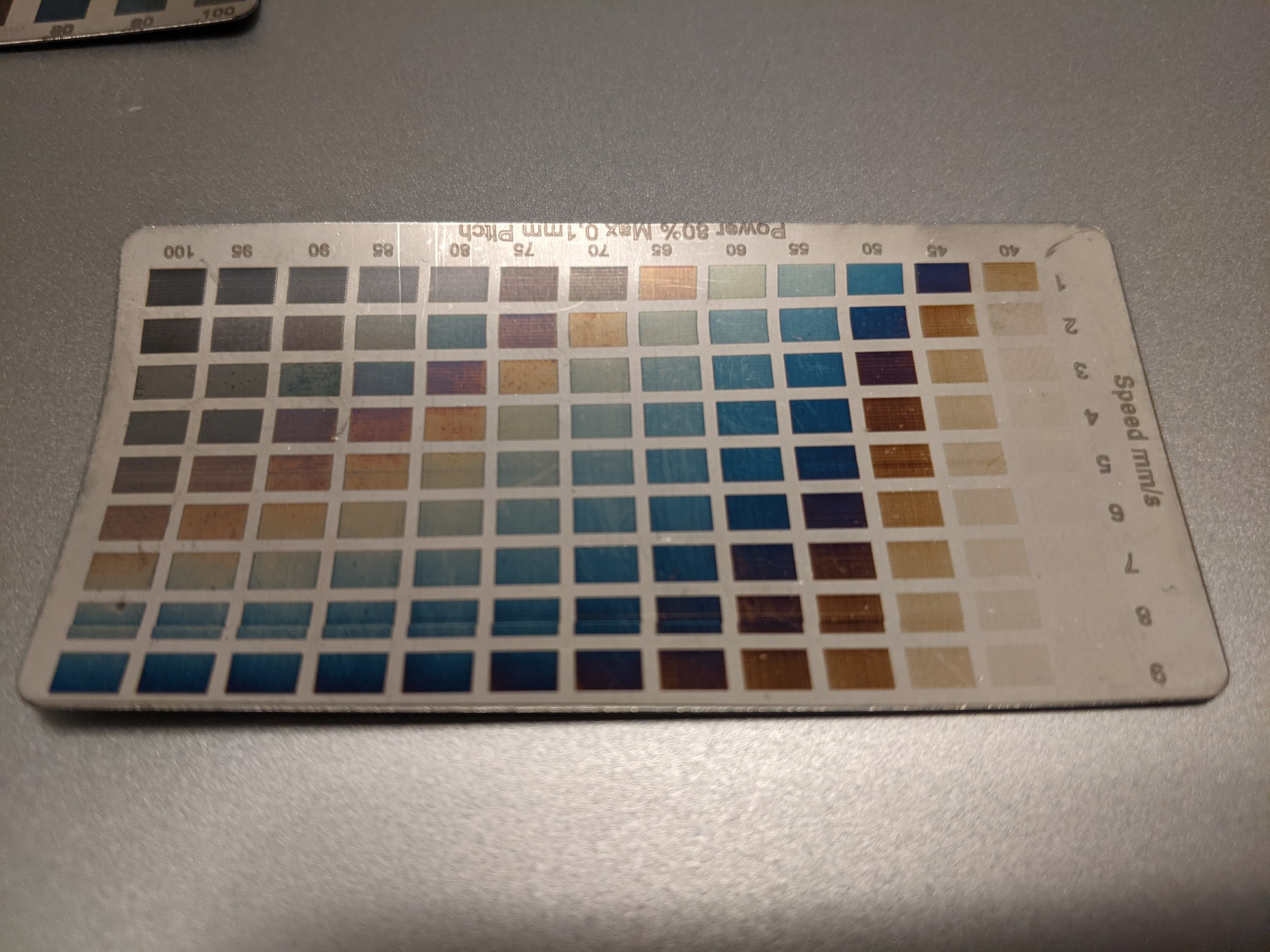

201 Stainless heat tint testing, number is mm/s.
100% power, 0.1mm pitch horizontal lines.
Need to find red and green.
At 60 mm/s and above, the head can’t speed up and change direction fast enough.
Didn’t this grid test vary the power?
No, 100% power and 0.1mm pitch, 1 pass for all.
Vary feed rate 1 mm/s to 10, 20 to 110, 11 to 19.
I’ll try 0.1mm/s to 0.9mm/s.
Maybe finer pitch, 0.05mm.

I see burn test grids that vary the power in the rows and the speed in the columns. Granted, my laser is lower power than yours, but the technique still applies. Most of the information I see recommends burning at well under 100% power to prolong the life of the laser. A little slower speed is a small price to pay.

I have no problem engraving and cutting wood. Well maybe too much power. Black engraving cut through the wood.
Somehow it’s easier to engrave on stainless then mild steel. Maybe the mild steel is too thick.
I’ll reduce max power to 80% and try again.
Thanks for the file. Learn better way to make a grid.
First run was 300 mm/s to 25 mm/s.
Power 80% max from 100% to 10%
Bottom 3 run was nothing. 100 mm/s at 100%(80) got a bit burn mark.
So I changed bottom 3 to 20, 15, 10 mm/s.
Colour change start at 50mm/s 50%(40).
I’ll rework the grid to start at 50 mm/s and power from 50-100%.
People were asking manufacturer how to get colour on 316. The answer was: “watch the video, setting is there”.
And their setting was 300 mm/s 80% max power.

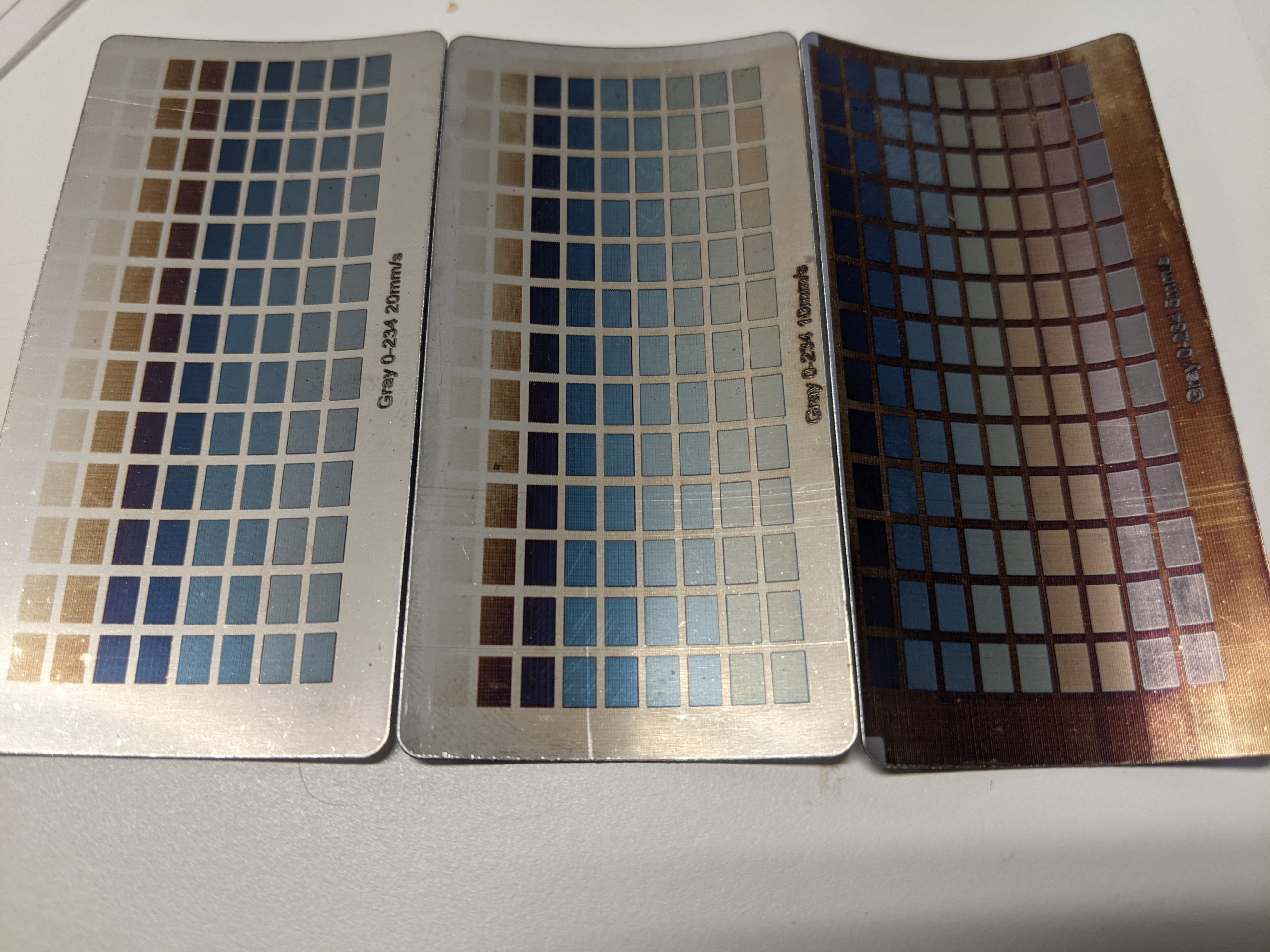

Sounds like they just run a gray scale line fill.
Gray scale and speed test, 0 to 234 step 2, bidirection.
Power 80-40%
3 speed, 20 10 5mm/s
Cut a wood ring to fix a knob and engrave on mild steel:
