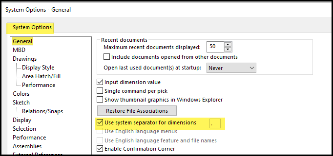

ISO standards indicate that either a comma or dot is acceptable. We may duel dimension for US designs but I don’t see that SolidWorks allows both, you have to set the decimal separator by the OS (default) or override and put in what you want.

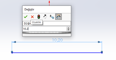

In addition, software (excel, autocad) uses dot.
SW can use both.

I’m not seeing where you change that setting. I guess if you set your drafting standard to ISO, it changes it to the comma?
To answer your question I think it’s a document property and not a system property. So, it will follow the document/part/asm. Someone please correct me if I’m wrong.
KennyG mattpeneguy
This setting is not a document specific setting controlled by a standard. ISO actually states that both a comma and a dot are acceptable and determined by the language and country in use.
In SolidWorks, it defaults to Windows and the language selected. You can uncheck and override it to whatever symbol you want. KennyG So to answer your question, one user can see commas while another user sees dots. This would seem to give each user their “preferred” view but once we publish a PDF viewable, it will be set to one or the other depending on the machine doing the publishing.
