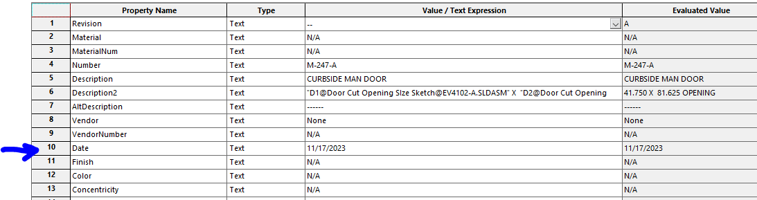

Every part and sub-assembly in an assembly has a “Date” custom property. When I do a pack & Go to make a new version they do not update, and they can be different vales (ie. The screenshot below has 11/17/2023 as the date on one part, but the other part has 12/01/2023). I want the macro to change all the date custom properties on each part and sub assembly in the assembly to change to the date I input in the macro.
This part M-247-A has a date of 11/17/2023
This part M-247-A-B1 has a date of 12/01/2023
After I did the pack & go and created these parts as part of the new assembly I got to go in and change the date on each one, some assembly’s have 30 or 40 parts where I have to open each one and change the date to 03/08/2024.
