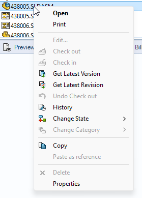

This is strange because I do not see this issue in my test vault. I’ve added the same add-in files to both vaults and I’m logged in as the same user. Here is the production vault:

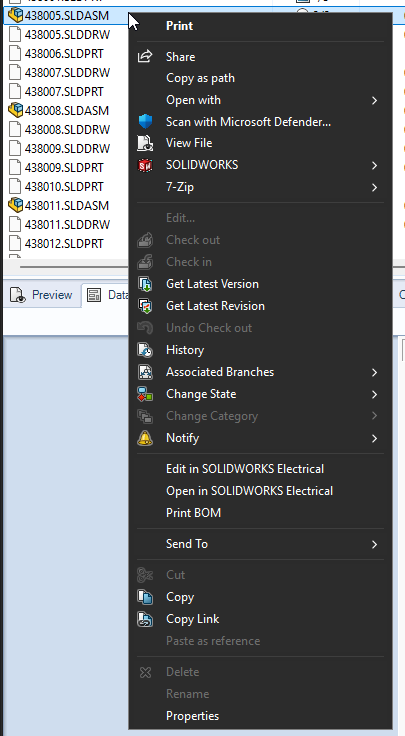

And here is the test vault:
The Print BOM menu item is provided by my add-in.
I have a another add-in that provides menu items and they show up
I’m also curious about the other differences in the menus. For example, the View File and Notify items are missing.

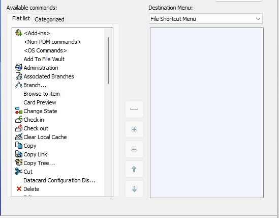

Did your menus get reset or changed in the user settings?
Not by me. However this does seem to be the problem. The File Shortcut Menu entry is completely empty:
This seems to have happened to only the File Shortcut Menu and only for one particular group. I recreated the correct entries and now everything is back to normal.
Unfortunately the UI shows it that way when editing the group and any of the users deviate from each other. The menu setting is really user specific, the group edit should applies to all users in the group.
