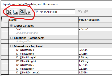

Try these various grouping options in the Equations dialog. You can group all the global variables at the top for easy access. I’m not sure you’d be able to create a cleaner/easier/better interface using a macro.
