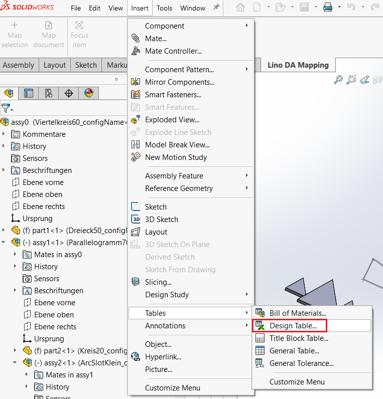

I just want to create a new design table, analog to this option in the GUI
but without any user interference and without the user noticing anything.
