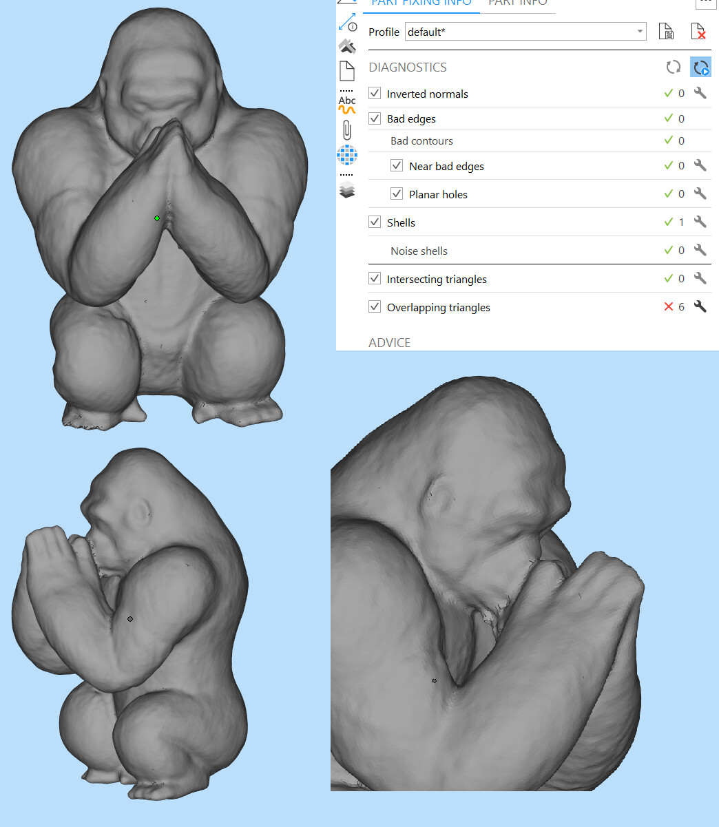

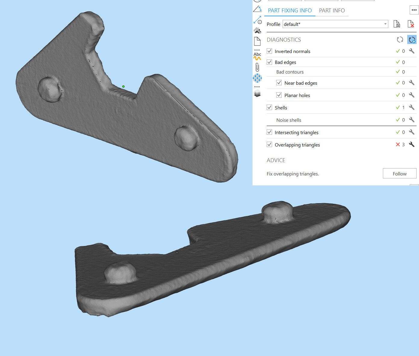

A coworker bought one, he lent it to me so I could run some tests. Here are the best results I got - mesh diagnosis from Materialise Magics:
Just a few Intersecting/Overlapping Triangles (These are minor issues for STL files, usually you don’t need to bother fixing them).
Black, glossy/reflective surfaces creates pretty bad scans, so you will need a scanning spray. (I didn’t use spray on those scans)
I would say it is not good for Reverse Engineering, but if you want to scan some toys and fix the mesh manually with sculpting software (zBrush, Blender, 3DS Max, Maya) it’s pretty decent.
