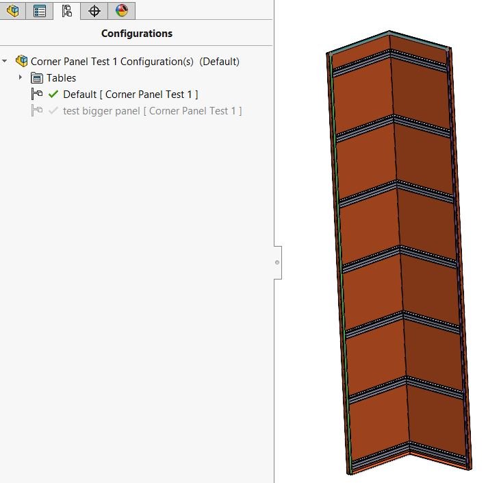

I’m newish to solidworks and trying to fully understand configurations. I have a panel that is an assembly of various parts. I have created 2 configurations of this which changes the size of all the parts, this is all working good. The issue is when I put these subassemblies into another master assembly I cant get the 2 configurations to display, it only seems to display one or the other. Is there a way to make this work, I would appreciate if someone could point me in the right direction. Thanks alot

Is this what you’re trying to achieve?
Check Assmebly1 in attached file.
You need to have configurations in Stiffeners & Top Angle too. Because these two parts’ length changes in your configs too.

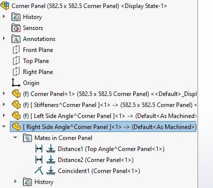

I have tried to recreate the solution but im still having an issue, one of the side angles wont move in the assembly. Its bizarre as I cant see any difference to the file you sent me, i dont think you even needed to do anything with the side angles? Would you mind to please have a look at the attached to see where im going wrong, i have spent hours on it and cant figure it out :blush:

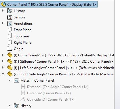

It’s because currently everything fixed. If it’s fixed it won’t move when the length of the panel changes. If you mate the angle to the panel
then it will move with the panel. Best practice is only have your first part fixed and use mates to locate all other parts in an assembly.
With mates added
In the other configuration will need to unsuppress the new mates.

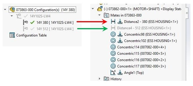

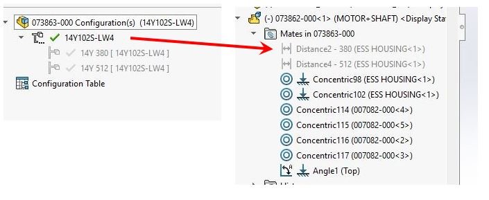

An example of using mates with configurations.
Have an RF filter with a frequency range of 380 - 512 and in the top level the distance mates are suppressed so I can move the tuning assembly thru its range of motion. Could’ve used a limit mate but didn’t need one.
With the 380 configuration the 380 mate is unsuppressed and in the 512 configuration the 512 mate is unsuppressed. Added the 380/512 mates to lock the assembly in position to design limit switch placement.
The 380 and 512 mate could have be done with (1) mate and by editing dimension for each configuration.
Sorry I was away for a while. As others have mentioned, you’ve fixed all components and it prevents them to move with the change in size and length. As you see in my uploaded assembly, I floated the side angles and added mates.
