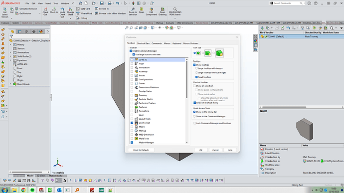

Since updating (from 2022) to 2025, my command manager has had a PDM tab on it. I don’t need anything on that tab because it’s all already available in the task pane on the side.
That wouldn’t be an issue except that it seems like every time I want a command from my manager, it is open to the PDM tab. I know that previously it wasn’t always on the right tab, but more often than not, it was. Now I have zero chance of that because the PDM tab is always active.
I have tried hiding it and deleting it through command manager customization and I have tried with Lock CommandManager and toolbars checked and unchecked. And no matter what I do, it always comes back. Sometimes it takes a restarting SW, sometimes it’s just opening a new file.
I have changed these settings on Assembly, part, and drawing files to no avail. Does anyone else have any other ideas?
