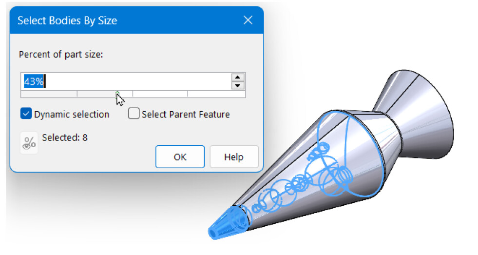

Coincidentally, SW 2026 has this new feature:
Only it doesn’t work as well as the macro above. Select by percent of part size??!
LOL that’s basically exactly the same as the macro! I’m guessing that the “Select Parent Feature” does the same thing as the button on the updated version…
