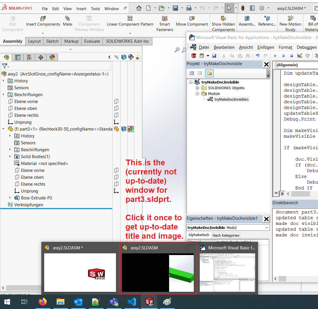

To reproduce:
I have attached such an assembly (assy2.sldasm) with such a component document (part3.sldprt) and a macro illustrating the problem (tryMakeDocInvisible.swp); all are in the zip file. If you manually open assy2.sldasm before running the macro, part3.sldprt will be already loaded invisibly; if you do not open anything before running the macro, part3.sldprt will be loaded invisibly by the macro. In both cases the macro tries to change design table settings in part3.sldprt and does not succeed (if part3.sldprt is invisible). Afterwards it makes part3.sldprt visible, tries again (now successfully), and reverts it to invisible.
But after the macro has run, you can mouse-over SolidWorks in the Windows task pane and will see an own mini window for part3.sldprt (it may not have the correct description and mini image, but if you click it once, it will update):
If you do not see that window, this is probably the case if you have not opened anything prior to calling the macro. In that case you can try switching to another program and back to SolidWorks; the window will sometimes show up then. If not, you will at least see “part3.sldprt” in the menu bar:
Then if you open a totally unrelated file and minimize it, you will be able to see part3.sldprt open in the background (but not necessarily in its own window).
You can play around with the macro by manually setting the bool variables startVisibility and makeVisible to True/False.
