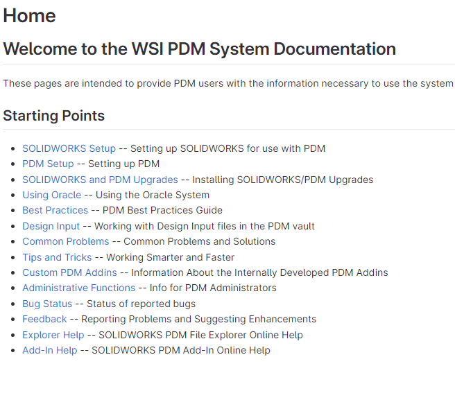

Not for PDM specifically but I use a self-managed Gitlab installation for managing my SOLIDWORKS/PDM add-ins and source code. It’s running on a Linux VM hosted on one of our in-house servers and its authentication is hooked into our Windows domain so users can login using their Windows credentials.
I recently started using the CI portion of Gitlab to automatically build and package my PDM add-ins anytime I tag a release using Git.
Gitlab includes a nice issue tracker (that ties into Git) and a wiki as well. I use the wiki instead of creating a bunch of word documents.
