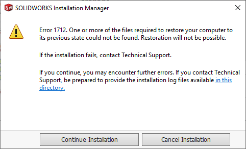

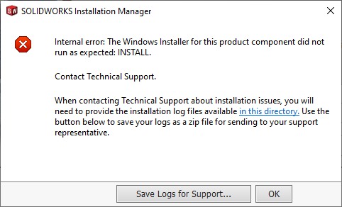

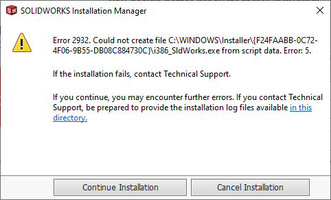

Why I get many errors when trying to install Solidworks 2023 in 64-bit Windows 10?
For example:
https://i.ibb.co/XWhF9jV/Solidworks-2023-Installation-Error.png
https://i.ibb.co/McVDX2t/Solidworks-2023-Installation-Error-02.png
https://i.ibb.co/mCZVLJF/Solidworks-2023-Installation-Error-03.png
https://i.ibb.co/Qn8H4mJ/Solidworks-2023-Installation-Error-04.png
And the Solidworks 2023 is failed to install?

have you downloaded all the files? to be sure the 15+gb full image including all the prerequisites, libraries etc?
did you start the setup executable from right mouse button, run as administrator?
do you have at least 15gb free space in your c: drive? (even if you plan to install sw elsewhere)
Yes.
No I’m not. I just do usual double click the setup.exe file.
Yes.
So what should I do next?
Try to run as Administrator then. The errors seem to point to something causing the files to not be created. Lack of space, lack of rights, missing setup files, something like that.
