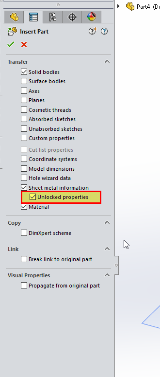

I’m not 100% sure but it’s something to do with adding “Thickness” custom property and checking the transfer option to “Unlocked properties”.
If that option is checked and Thickness in the custom properties the mirrored file is corrupt and usually crashes Solidworks on close. My testing wasn’t 100% consistent so there must be something I changed and didn’t notice. I’m tired of messing with it, I found a way to be able to mirror the model I started with, uncheck that setting when mirroring.

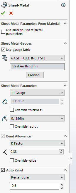

Are you using a gauge table? We found that derived parts consistently demonstrate unintended non-functionality when a gauge table is used.
Are you kidding me?!? Of course, we’re using a gauge table. It’s not like someone laid out a map of the minefield for us before we started trying to remodel our entire parts base in SW. o[
Unfortunately, I’m not kidding. ()
A mirrored copy of a part is an inserted part (Solid Edge handles it the same way, except they call it Insert Part Copy). The problem we ran into was exactly what you described; any time a part with a gauge table is inserted into another part you’ll get errors. This rears its ugly head for mirrored parts as well as the workflows using the Insert Part/Delete Bodies or the Save Bodies methods of breaking up a master model.
The solution we discovered was to uncheck Sheet metal information when inserting a part into a part or mirroring in an assembly context. This creates a derived part without any sheet metal features. Next convert the derived part to sheet metal and manually key in the sheet metal parameters. You cannot use a gauge table on derived parts. Full stop. This drove me straight up the wall until I submitted to the software. :cry:

The wording of that warning makes me think that SW embeds a copy of the gauge table into the part when the gauge table is selected for the first sheet metal feature. I hope I’m wrong or that there’s a way to update the embedded table if ever needed.

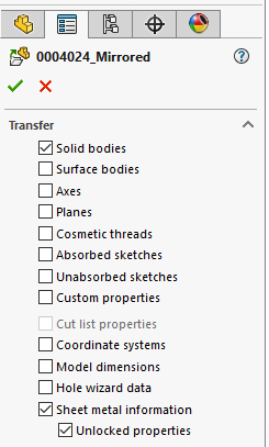

bnemec No crash in 2020sp5. Do you have the version to test? Of course when it inserted the bend table in the mirror it used the default bend table since I don’t have yours. Not sure if that’s a factor.
A copy of the bend table is embedded but I don’t see how it affects anything in the mirror. Even if I override and change the k-factor the flat doesn’t change.

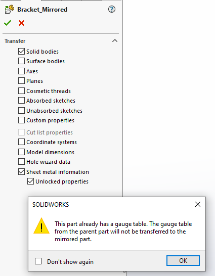

sorry to ask the obvious, but you’re saying when you make a mirrored part from one that I attached with those options selected from my earlier post the new file would save just fine?
Does the new file use the gauge table from parent part or yours?
Also, could be what variables are used in our custom properties in the part template.
I do not have a new version of SW, multiple installations is a portion of the minefield I have not yet explored.
Yes, it saved fine and I can reopen it.
It shows your gauge table in the description, I thought it was the default but I’m not sure. After creating the mirror part, excel opens for a second and I can see the gauge table but I don’t for sure if its yours.
Here’s the gauge table popup:
That is ours. I have never seen excel open, even for just a second, when mirroring or setting sheet metal options to a gauge table.
