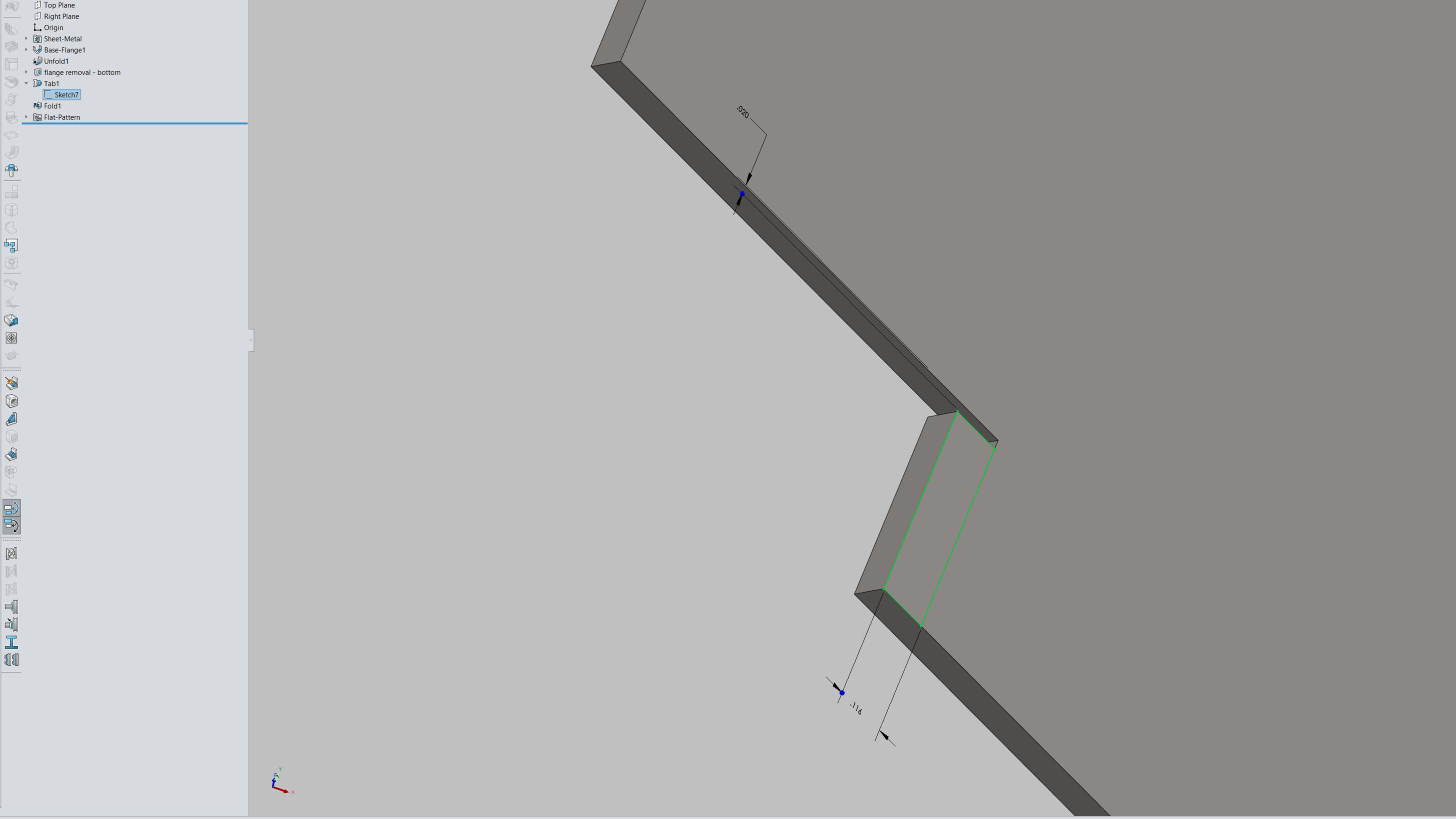

I’m having difficulty getting the attached part, 8575-09-02_CADForum.SLDPRT, to properly flatten.
The issue can be traced to the “flange fills - bottom” feature. If that feature is suppressed, the part will flatten.
Seeing my design intent in that feature, is there anything I could perhaps do differently?

The feature between your unfold and fold where you add material by the bend is causing the issue. I’m not sure what to suggest though.
o[ SO I just checked into this part and AlexB has it correct. That added material is the issue. Try building the part by adding the 90° side flanges last & see if that works. I have had issues in the past arc’s & flanges not playing well together. Might be something to talk to your VAR about as I think it should be able to flatten as you have it built.
I saved the part back to 2023 & built it as stated and was able to get it to flatten but when I bring it into 2024 it does not. o[
FWIW: (Using 2024/2.0) it’ll flatten if the left side of the sketch is changed to construction lines or the flange is flush/behind the bend.

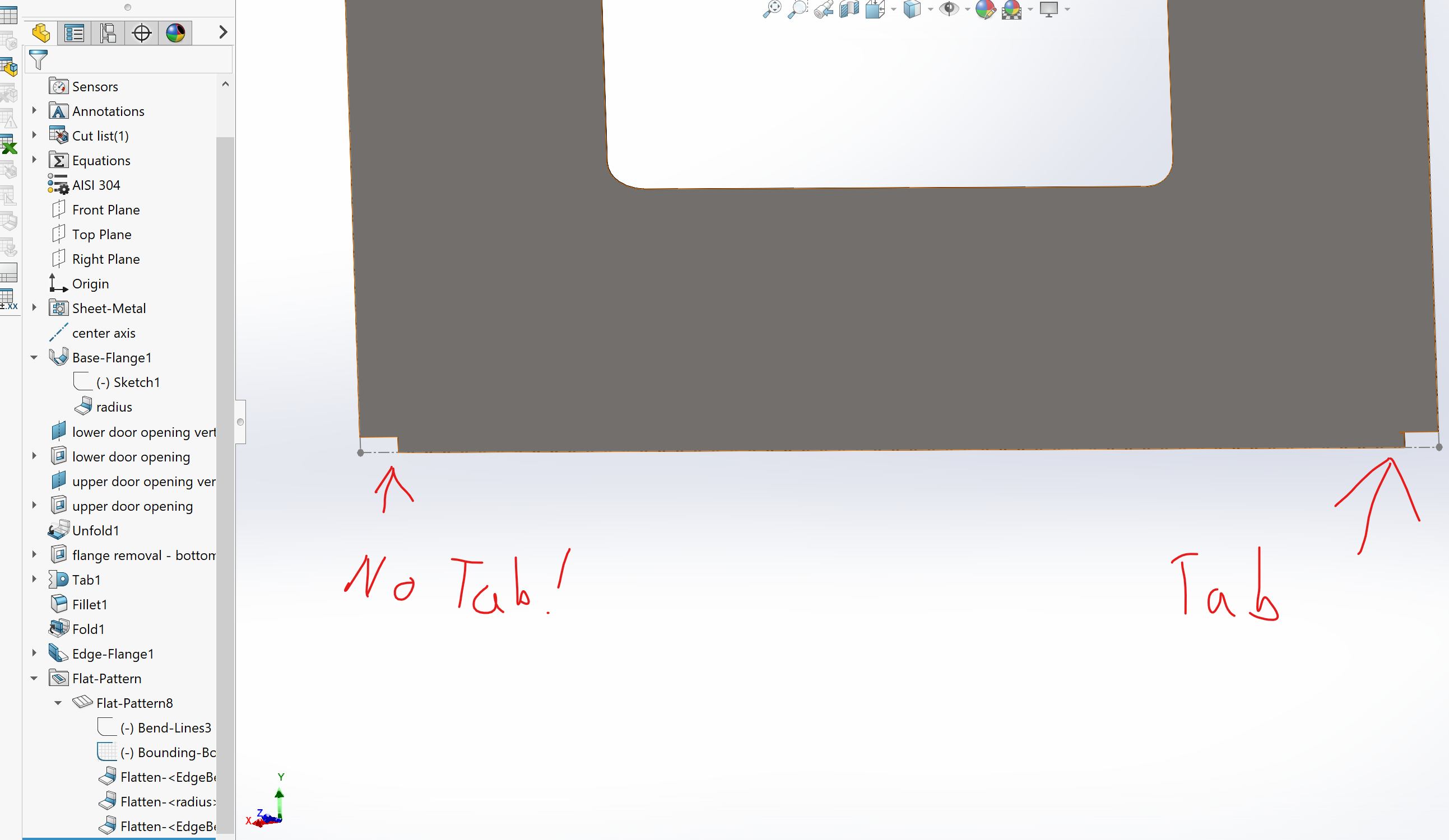

This works, but it’s not “correct”. I wish there was a way to stop the bend at the point at which the flange ends.
ETA: There does not seem to be a way to edit the “Bend-Lines” sketch, which would, in theory, do the trick.

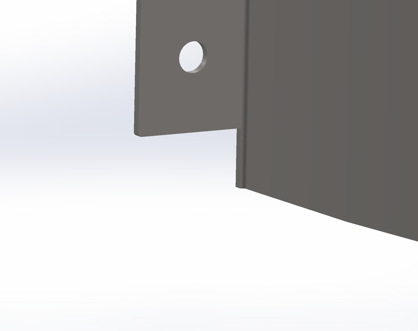

It looks like SW doesn’t like two (or more) bend radii in the same zone. I would imagine that you could get by with adding a flat boss at the end. I am unable to use your file since it is a future version (I’m on 2020) for me but I get the gist from an eDrawings file of your model.
Yep as mentioned it seems its a situation SW can’t handle. i tried to do it in every different way i could think of and no matter what, that same area errors out when it comes to generating the flat pattern. As soon as the Rolled section enters past the tangent location of the edge flange radius… Computer Says No.

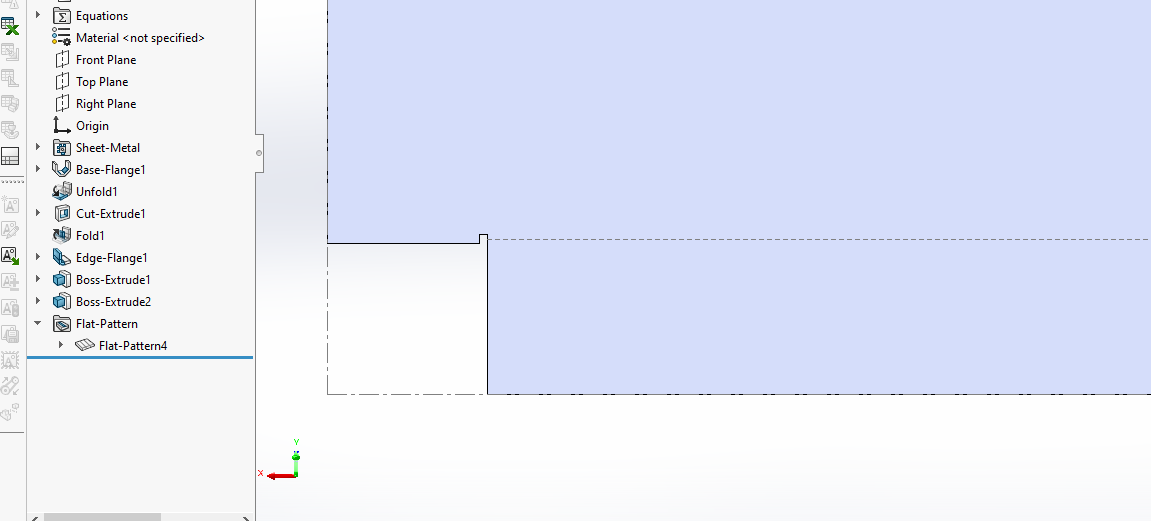

So Dennis Bacon You are partly correct. If I change things up a bit & model it a bit differently I can get it to unfold, mostly correct. I still think that it is something that needs to be reported to Solid works.
First I made just an arc that stops at the point of the start of the Edge Flange bends. I then unfolded the part and made a cut on the end where the flange had been removed. (for a relieve notch). At that point I added the merged boss on one side and folded the part.
I then added the 2 90° edge flanges. I can now flatten the part but I only have the merged boss on one side. If I add the other side the part will not flatten! o[
