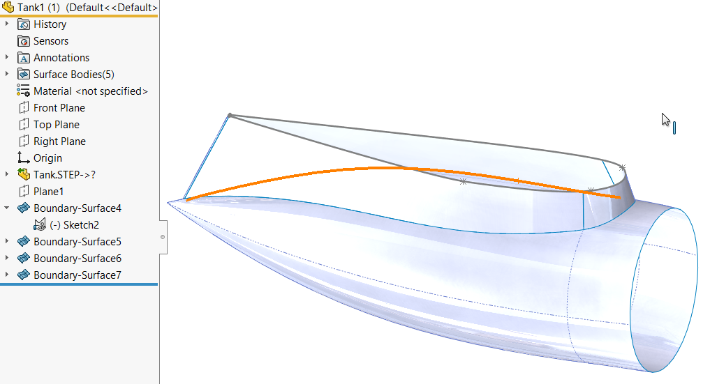

This may or may not be what you’re looking for. I was able to do it, but it wasn’t pretty. I did it one pair of edges at a time. And because the spline was only 2 segments instead of 4, like the edge, I had to use the connectors to split it up.
Probably not correct, but here’s an attempt.
Tank1.SLDPRT (316 KB)
You both generally achieved what I can’t but I still cannot figure out how. Did you have any difficulty selecting the projected curve (non-planar, on the Cone shaped Surface). If I try to select if for a Boundary surface it just says “error”.

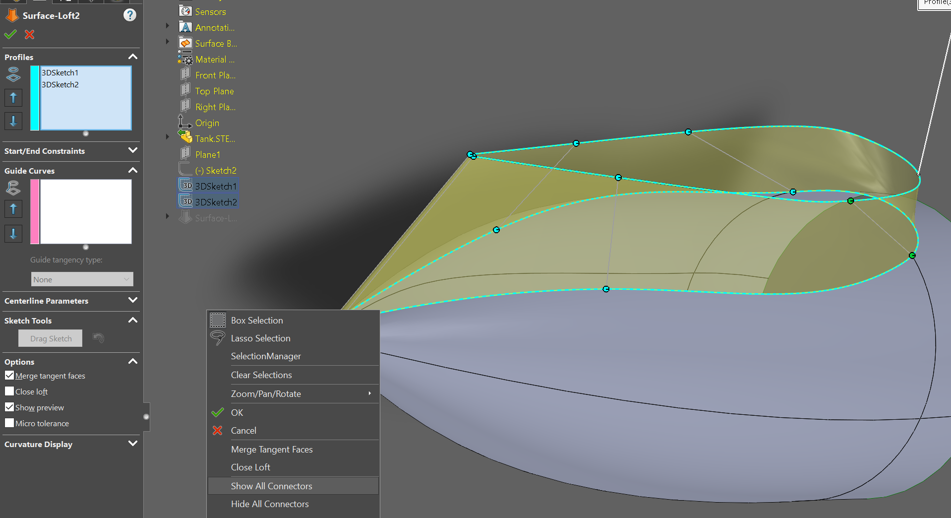

I did it by doing two 3DSketches Converting Entities from the Edges and the 2D Sketch you left, and positioning the connectors.
I think the way the segments are split is generating bad geometry.
[attachment=1]image.png[/attachment]
<LINK_TEXT text=“https://www.youtube.com/watch?v=tYfJr3C … dgeSystems”>https://www.youtube.com/watch?v=tYfJr3Cb-R4&amp;ab_channel=HawkRidgeSystems</LINK_TEXT>
Also with Loft you could click on Show All Connectors and drag then, if you get lazy to make the Guide Curves. lol
(It would make a self-intersecting surface otherwise)
I had to play with it a little and I think Lucas is onto the problem. With Surfaces SW has to make some assumptions if you don’t explicitly tell it what to do. SW will outright refuse to do something that will create a self intersecting surface. So, that’s likely the problem and why you get the error.
I didn’t know about showing all the connectors, that’s a handy trick.
