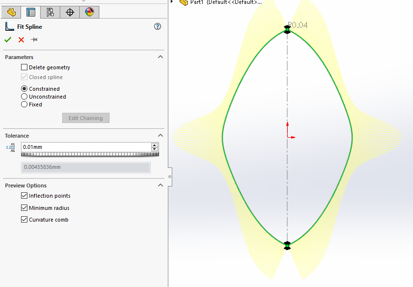

In SW you could try a Fit Spline?
2018 attached
MirrorEqCurveAndFitSpline.SLDPRT (51.4 KB)
