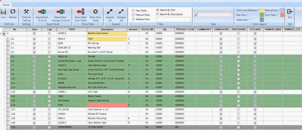

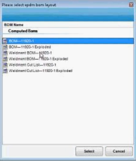

Disclaimer: I know the pictures are blurry, this is the resolution it was recorded in unfortunately.
I had to go digging to get this info from our demonstration of the full CADLink package. Essentially, there are two steps to exporting a BOM from SW to your ERP. Set up your EBOM, then your MBOM. We ended up deciding this wasn’t for us, but it may work for others.
  1. Ensure your SW BOM [EBOM] has all of the mechanical structure that you need at this level. Send to CADLink from PDM.
  2. CADLink editor opens your selected Computed BOM and allows you to begin editing it before it moves to your ERP system. This is where, from my understanding, you can add manufacturing items and stuff for your MBOM and make other changes to non-SW fields before upload. I think they have a solution for routings, but I don’t know since it wasn’t covered with us.
  3. Once the differences have been resolved and everything is ready to upload, you can then push the changes to your ERP
They described it as essentially having a middle-man SQL database that holds the modified data that’s exported from SW. It compares this to your ERP system and PDM to show you if things disagree and allow you to resolve them before they’re uploaded.

My understanding is that the data it pulls in from PDM is compared directly against the current BOM from the ERP system. It will let you know if something is going to be added by marking it green. If something is deleted it is marked gray. And if the user needs to choose the correct data from conflicting fields, you can specify whether EBOM or ERP should “win” that conflict.
I feel like applying this on existing BOMs would mark all MBOM items as “going to be deleted” since they aren’t present in the intermediate database prior to this current operation, but I can’t be sure since this wasn’t covered. Perhaps the intermediate database can be loaded with current ERP data prior to implementing the tool allowing it to work as described. It’s hard to say without actually getting my hands on it for testing.
