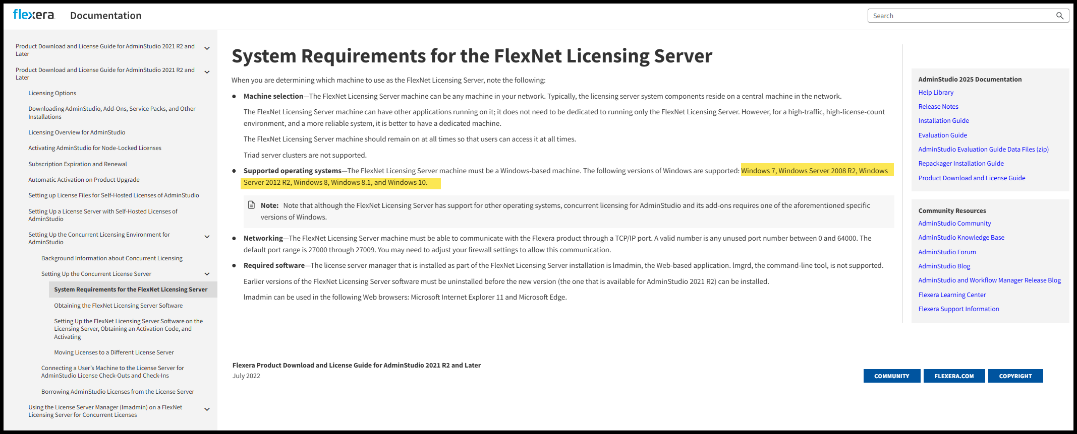

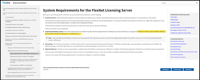

This is a gray area. I know for a fact it does work on Windows 10/11. Even the Flexera documentation indicates it.
Of course they can claim it works, from the technical point of view running a win32 or win64 service poses no problem at all. From a licensing point of view MS has the EULA they explained above and the clear client-server architecture of flexera et similar is not gray: they require a server side and license wise you should not host it on a windows 11 machine.
