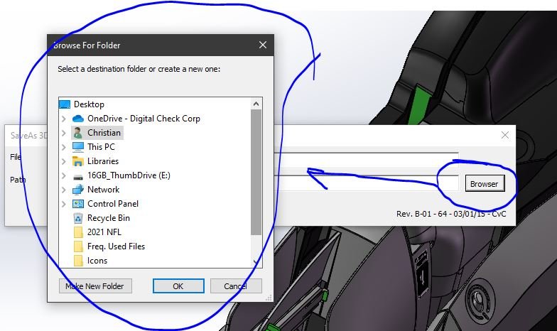

you can have option to use NET macro as it has FolderBrowserDialog built-in
However, if you decide to stay with VBA macro, then you need to include win32 API for folder browser (see att. image)

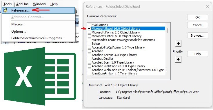

Option to select a folder in a convenient window using the Excel API in Solidworks VBA. I’ll leave this here.
Dim xlApp As Excel.Application
