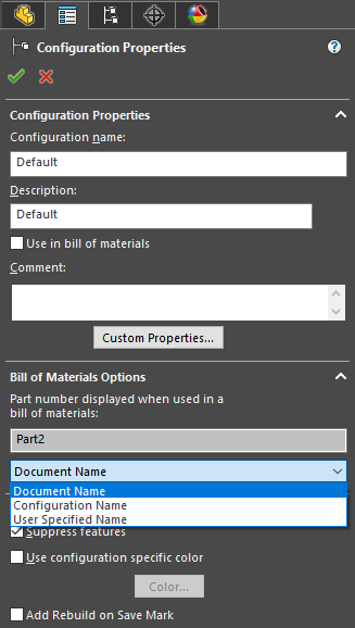

Now I just need to figure out a way to have the Configuration to default select the Document Name for Part Number in the BOM instead of the configuration name…
That is controlled by your part template.

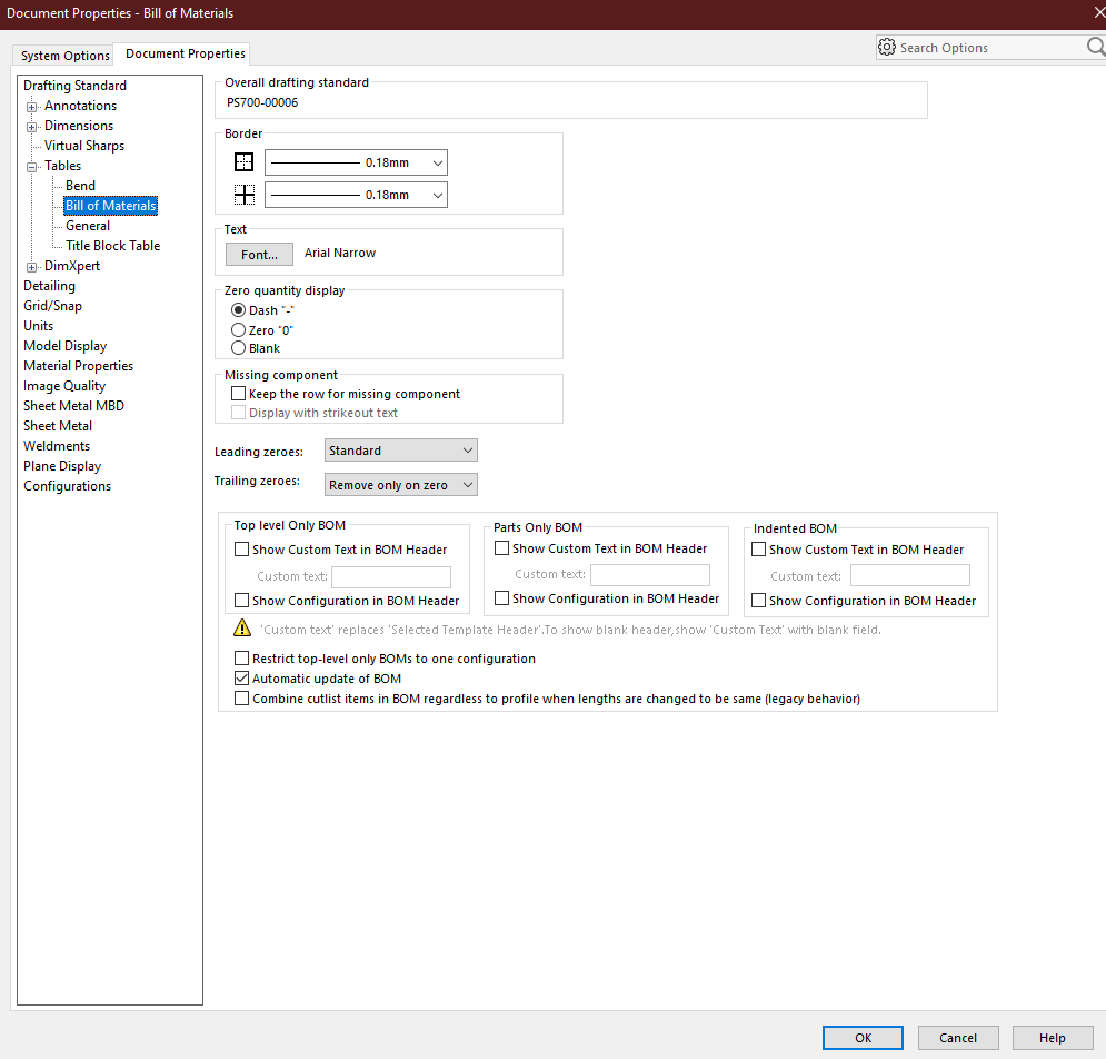

Could you point me to where that setting is? I couldn’t find anything obvious in the Document Settings that would control this behavior.
In Configuration Prosperities, the label is for “Bill of Materials Options” but I can’t seem to find anything similar to control the default setting
The BOM options look like it’s only controlling the BOM table headers

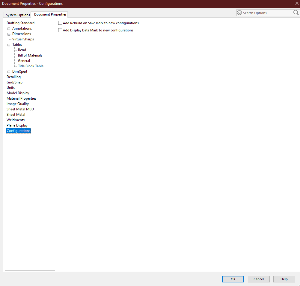

The Configuration options seem to be primarily to do with data marks and saving
If you open your document template (.prtdot) and change the setting in the Configuration Properties (your first image above) and then save the template, any future parts made with that template will default to that setting.
Perhaps the Part template needs to have more than the Default configuration because I opened the template, set the Configuration BOM Options to use Document Name for Part number (for Default config), and saved the template file. When making a new part with the Design Table, it’s still using the Configuration Name for the generated configurations in the BOM Options and I have change each one manually to Document Name. I’ll do more testing later, but this has gotten me 97% of where I need to be, so thank you JSculley.
FYI, for anyone coming across this later. If you set LENGTH as your BOM Quantity for the configurations before you make the Design Table, that setting will carry thru to all the generated configurations. If you do this after, you will need to do it for each configuration manually.
