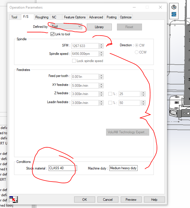

When you do your programming under the opertation in the F/S (Feeds and Speeds) tab you have the option to define the speeds and feeds by “Library”, “Tool” and “Operation”. If you select “Tool” and check the “Link to Tool” SW CAM/CAMWorks will link the Speeds and feeds of that tool to the proper material group.
If all your tools are set up properly, which I highly recommend, then all you have to do is switch the material the SW CAM/CAMWorks file the way I showed earlier and all the speeds and feeds will update accordingly.
So if you wanted to run a 6061 part with the same tool as a 4140 part just switch and done.
