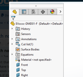

If you right click on EVxxxx-DMD01-F on the excerpt above and select Tree Display then select Show Flat Tree View does this move Sketch4 before Sketch1. If so it may be possible to drag Sketch 4 below Sketch1 and solve your problem.
