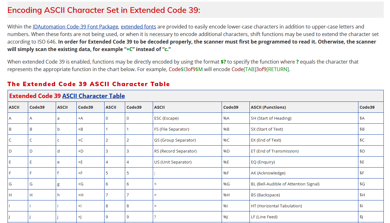

When I converted the bar code to text the ERP is adding a “$%” in front of everything. We are using Code 39 which uses an “*” as a start and end character. “$” and “%” are special characters that are used to create other functions.
So when I look at the font from the ERP everything is “$%[Data]”. Now this works fine for any numeric data, so “$%123456” ends up being scanned properly as “123456” as the “$%” is ignored because these special characters only create something “Special” when they precede a letter…where in lies the problem. So while numerics work fine something like “$%DEFGH” ends up scanning as “$EFGH” because “%D” is code for the special character “Record Space” so the “%D” ends up getting pulled out, the “$” is no longer ignored because it is actually a record on it’s own so you end up scanning two records “$” and “EFGH”.

So, it sounds like you have the extended/full ASCII set enable in your scanner. If you bring it back to standard, this shouldn’t happen.
“Code 39 has a standard and an extended/“full ASCII” character set. The standard set only encodes digits 0-9, upper case letters A-Z and a few special characters like ±/%$ (43 characters in total). The extended/“full ASCII” character set is usually (on all barcode scanners that I’ve seen) disabled by factory defaults. You have to enable it by scanning some configuration barcodes from the barcode scanner manual.”
Hmmmm, so you’re saying that if the Extended ASCII code is disabled it will ignore the “$%” entirely? I’ll try that and see if it works, I’m pretty sure I saw a “Disable extended ASCII” Scan in the setup book.
I’d been looking at those which is how I realized what was going on but it never struck me that those were all “Extended only”.
That might work.

You sir win the internet for the day. Went down and switched off Extended ASCII and BOOM actually worked as expected.
Thank You a TON!.
