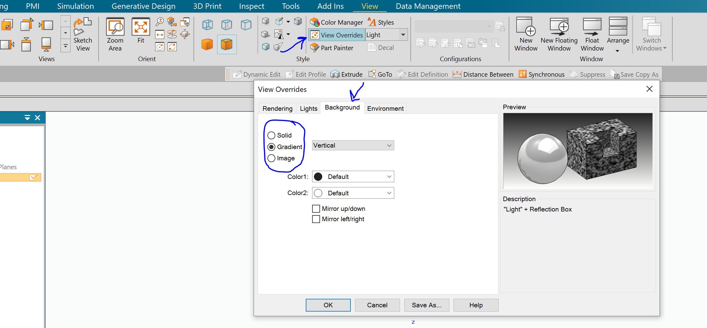

Select your preferred standard. Just remember what it is. In this case I have chosen “DIN Metric”
Make your changes…

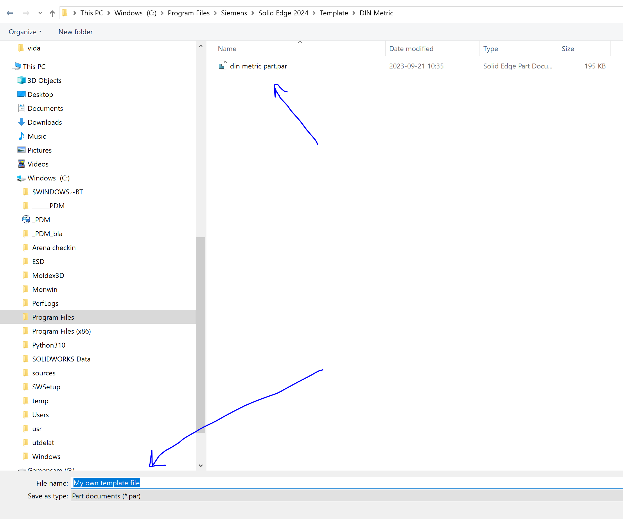

Save as …
Navigate to your installed template folder and go into the chosen standard.
Here you can chose to save as the old file or make a new one.
Here I decide to save it to new filename.

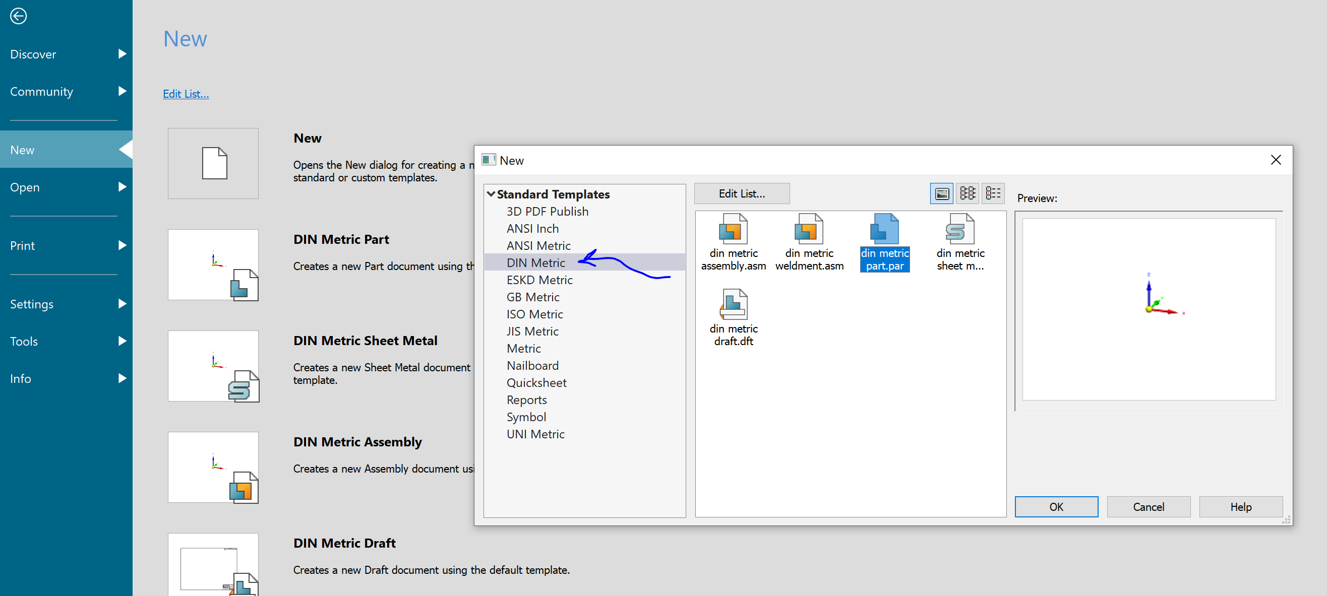

So next time I want to make a new file I have the option to chose my new template.
