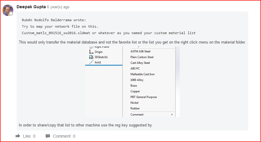

in the digging I have done, it looks like it can only be saved by copying a reg key.
Here is one example:
https://r1132100503382-eu1-3dswym.3dexperience.3ds.com/community/swym:prd:R1132100503382:community:yUw32GbYTEqKdgY7-jbZPg?content=swym:prd:R1132100503382:qnaquestion:tRA1CV3KSTaeUqpQ0aZI6Q
Response from gupta9665 6 years ago:
He doesn’t mention the reg key though. So I am not sure.
I haven’t tested this, but it looks like this is it.
Computer\HKEY_CURRENT_USER\Software\SolidWorks\Solidworks 202X\Material
