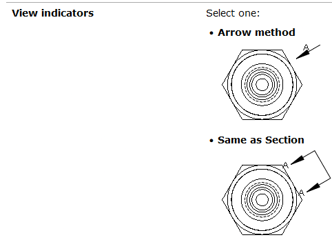

Now from the same document properties I tried to change the font thickness of the auxiliary view, but it seems to affect only the section line when the arrow is set to behave the same a a section view. The arrow font itself is not changing, so we have a thick section arrow and a the same arrow but thin for the aux views, which thickness cannot be changed?

Found the answer in the swamp: if the views are set to the layer -none- the arrow thickness is defauted to some general system options and do not follow the document properties…
As a reference for layers (https://www.goengineer.com/blog/use-layers-solidworks-drawings)
By default, you will have three choices:
-Per standard- will reference the document properties.
-None- is general and references the system options.
FORMAT is everything on the sheet format.
